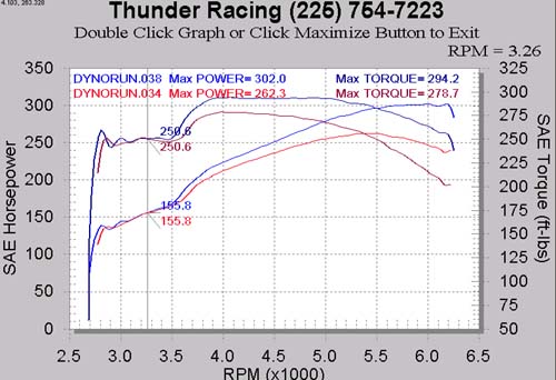

Well, the boss finally decided to do a cam swap in his daily driver, and after deciding on a new custom grind, we have the results!
First, a little background info. on his truck. It's an '02 Chverolet ECSB 1500 with the 5.3L and many bolt-ons(Arizona Speed & Marine headers with custom exhaust using a Hooker muffler, K&N FIPK, ASP underdrive pulley, and free mods).
The camshaft is a truck version of the popular "Old Man" cam in our custom grind series. Specs: 214/220 .600/.525 115+2 LSA.
The 2 dyno runs compared are from before/after cam swap only!
+40 peak rwhp for a daily driver that sounds like stock!

Hot dam. Looks good to me! I hope my numbers turn out good. I havent dynoed yet.

that is great numbers. wonder how it would do with the same mods minus the headers.

Was that a stock cam to start with?

I think he was just wondering if the new cam was dynoed against a stock cam.
