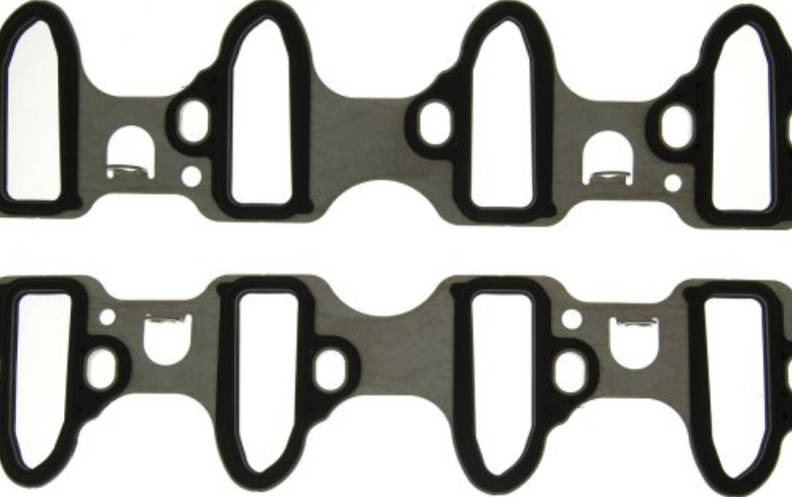

It's likely the intake manifold gaskets. If they are orange or red, change them to the new greenish blue style.

i have already replaced intake gaskets when i did the knock sensors a few years ago and they where a teal color.

These are the best intake gaskets for cathedral trucks....and we have em for ALOT less than your local parts store.

i went out there and sprayed carb tb cleaner around the intake, only thing i noticed was that the pcv valve wasn't in the valve cover, witch i just put back in. the intake gaskets where Mr Gasket i believe.
