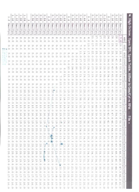

7.50g/cyl??? the table only goes to 1.2g/cyl
Grams per Cylinder is figured by: [(grams per second) x 15] / engine RPM
Here is one of my older timing tables just for referrence on the lower rpm numbers (i'm boosted too, so you can get away with more -be aware of knock):

Here is my latest table.
I was way wrong - I'm only at the mid-teens down low - I looked at a log and thought I was set to 20 down there.
I just looked at one of my runs at the strip, and I'm actually getting something very similar... I just never paid any attention to it.
Here's it is...
This was before headers... and I cut a 2.13 at full street weight and near full tank of gas. I thought that was fair, so I never looked into the timing dip.

At the timeing dip it's at 7.50g/cyl..
Oops,I was wrong.It's at 0.63g/cyl.. Im going to try playing with the High octane timeing table a little and see if that works.When would i have to use the low octane timeing table?Dont it read off that table if you get bad gas or alot of knock?

I have been adding a little timeing to 60-72g/cyl to 2000 rpm at a time and it looks a little better..But, Im still getting the timeing dip..What would smoothing do?
