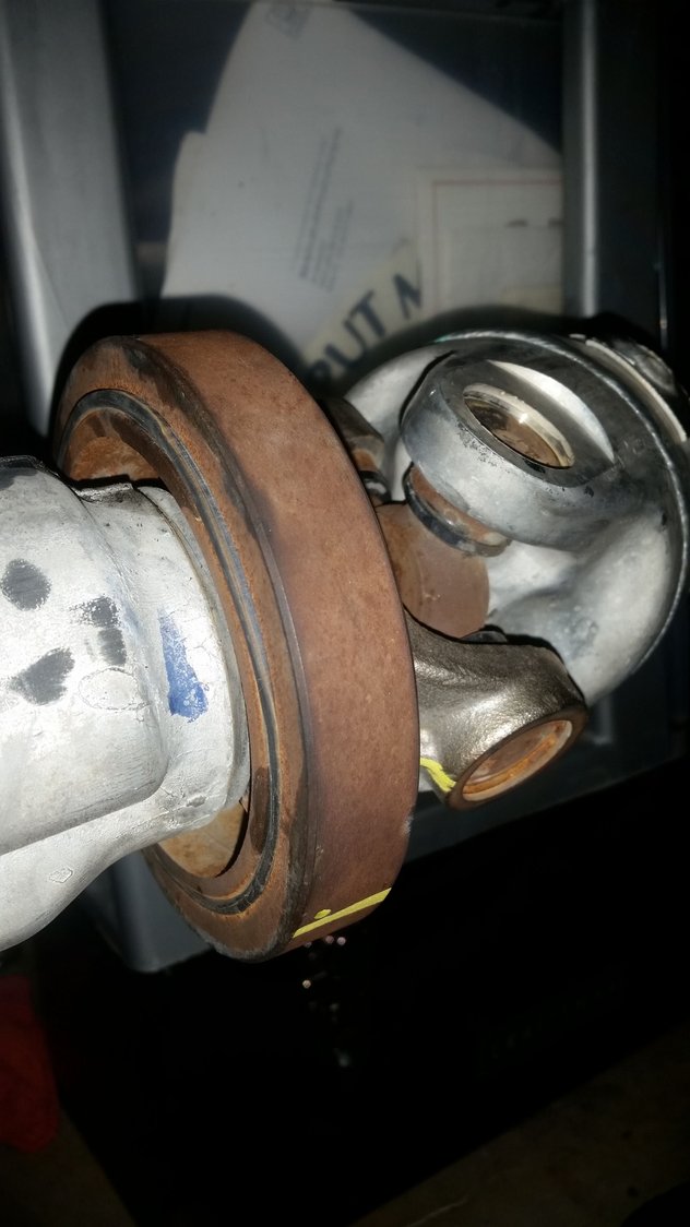

Take a pic at an angle looking back towrds the yoke/balance ring, if you can...

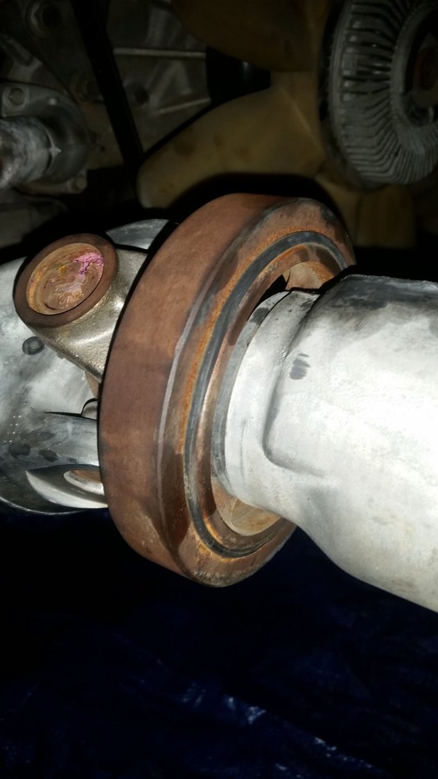

Old Oct 11, 2015 | 11:07 PM
  #63
Wolftrk99's Avatar
Joined: Jun 2013
Posts: 5,492
Likes: 48
From: Virginia Beach,VA
Yeah that is jammed up against and inside the seal, holy ****!!! If you have a long punch or chisel, or even a fairly large screwdriver you dont care much about put it againts the closest part of the yoke you can to the tailshaft housing and take the biggest hammer you have and knock the crap out of it...

Anything outside the black ring will defeat the purpose its a rubber dampener that allows the outer part to flex to absorb vibrations, same as a harmonic dampener wuld on a crankshaft!!

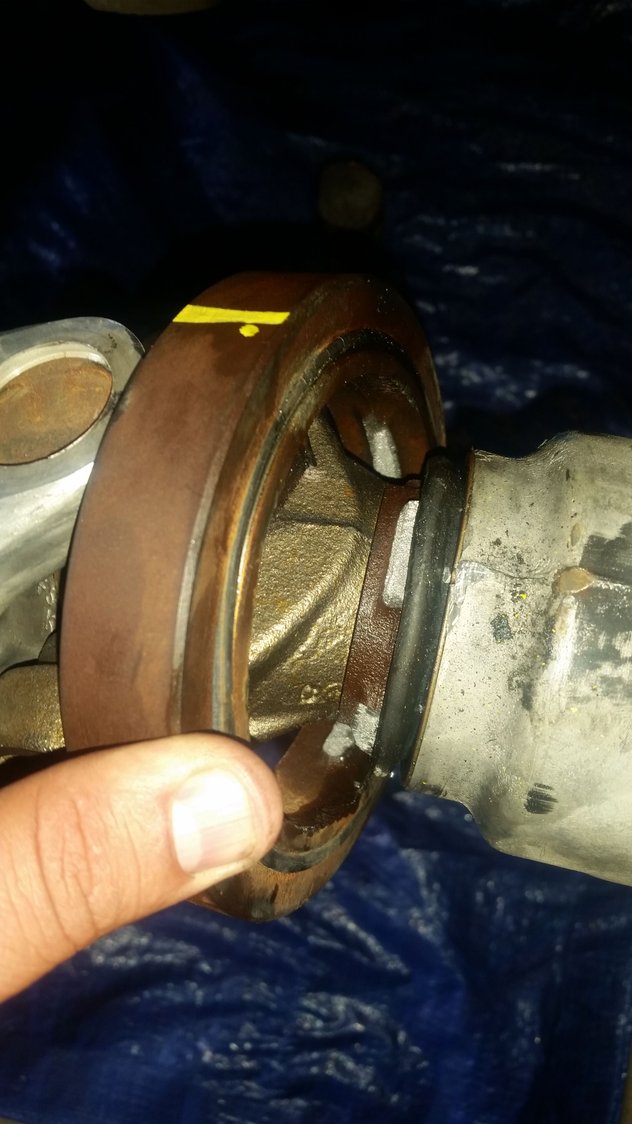

Balance ring ended up breaking,
Old Oct 12, 2015 | 07:20 PM
  #68
Wolftrk99's Avatar
Joined: Jun 2013
Posts: 5,492
Likes: 48
Good now you can actually hit the yoke, bit im beginning think that was fron being rear ended...

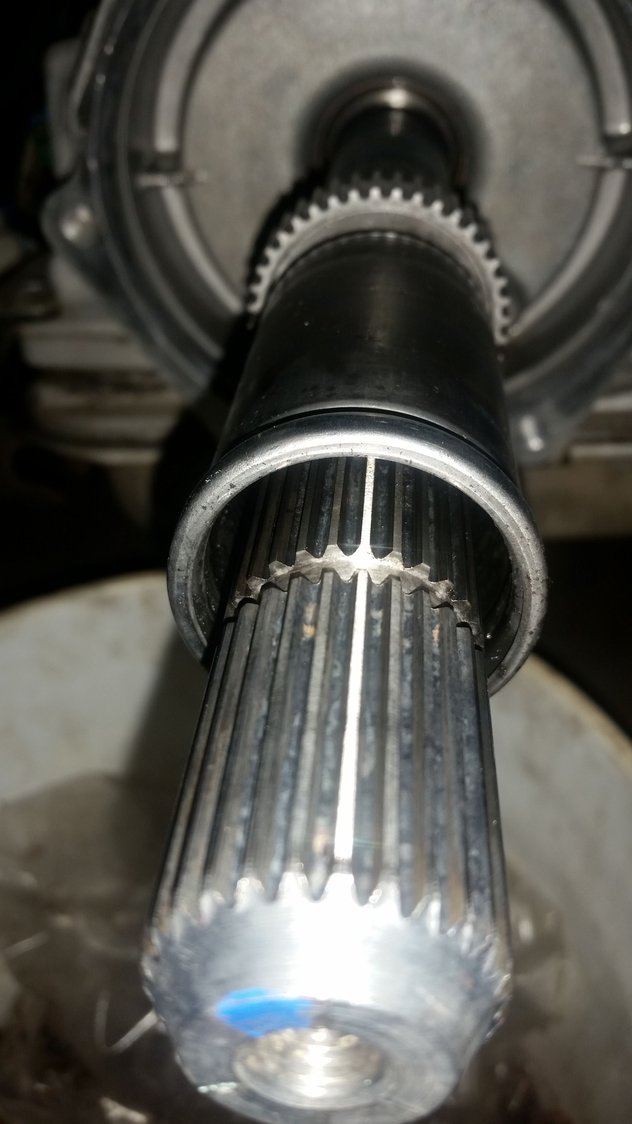

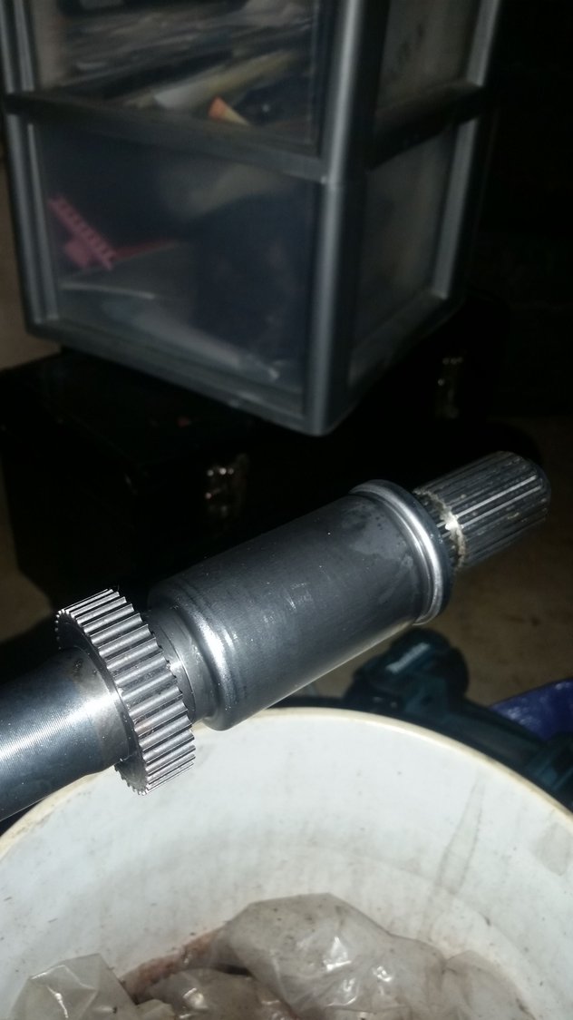

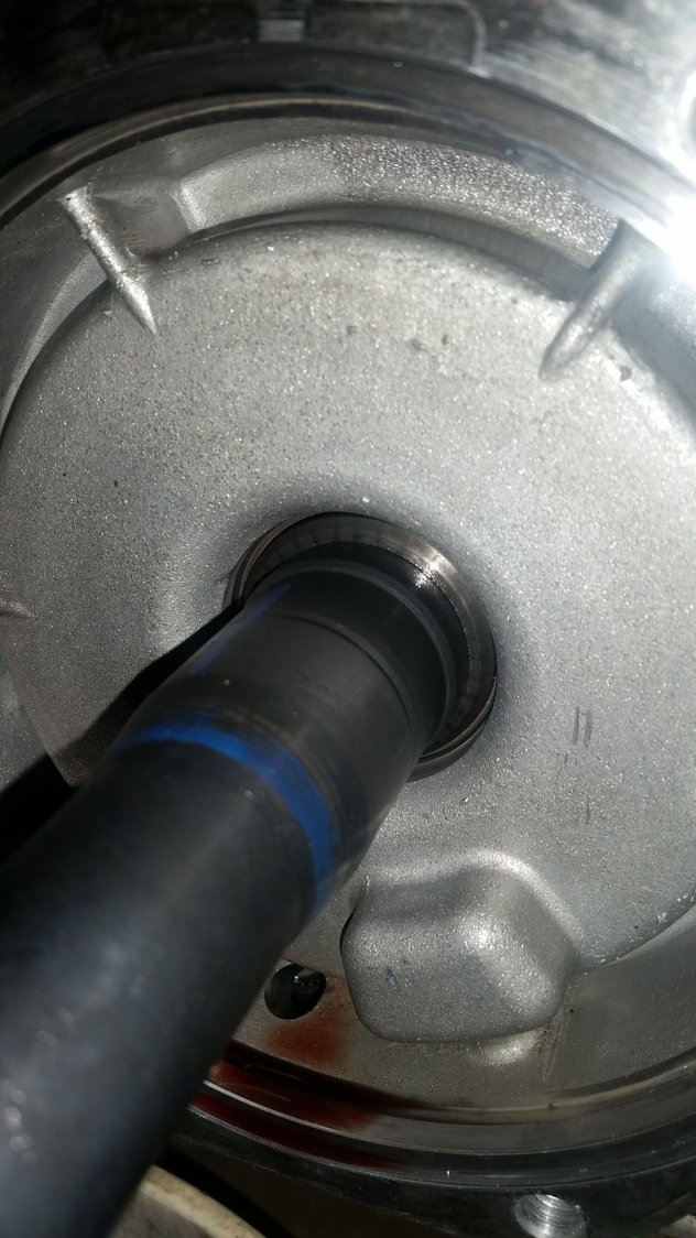

Finally came off hitting the yoke, how can I tell if it was damaged? Will my yoke out of my 2000 4l60e work? Here are some pics.
