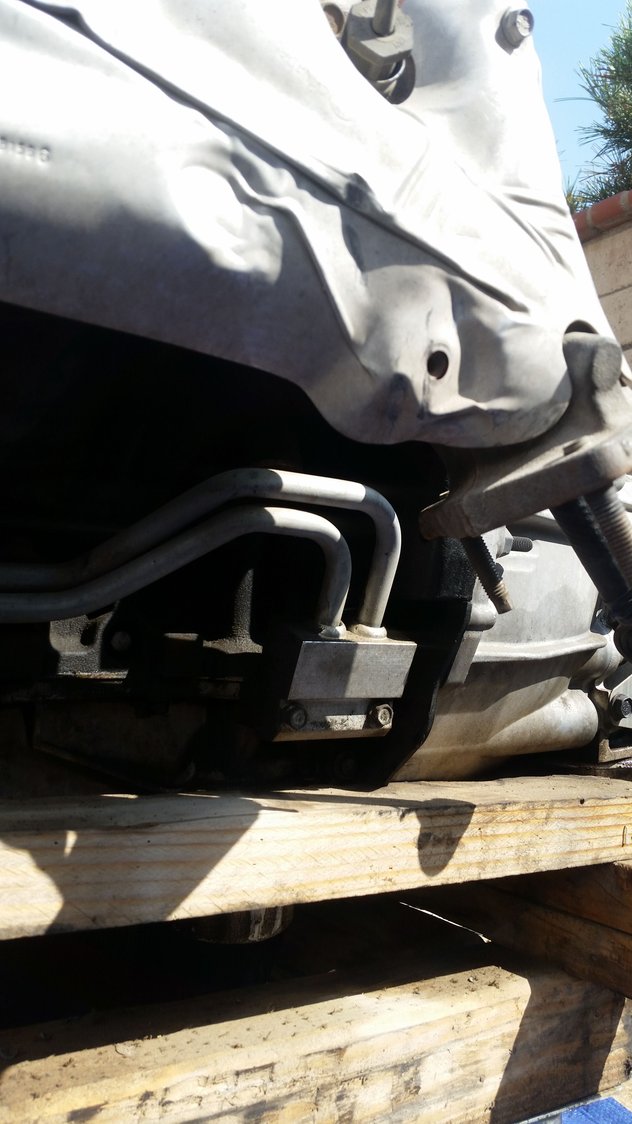

Can someone tell me were this lines go to? My 2000 5.3 does not have them. Should I use them?

Oil cooler lines, go to driver side tank of radiator, if your radiator doesnt have provisions for it take block off plate off the engine coming out and block it off

Just clean it up first
Well I'm actually buying a new radiator due to the fact that I'm putting efans on my truck and my old radiator won't work, I should just buy the one that has for the oil lines right? Is it better to have?thanks

Most of the aftermarket radiators have the fittings

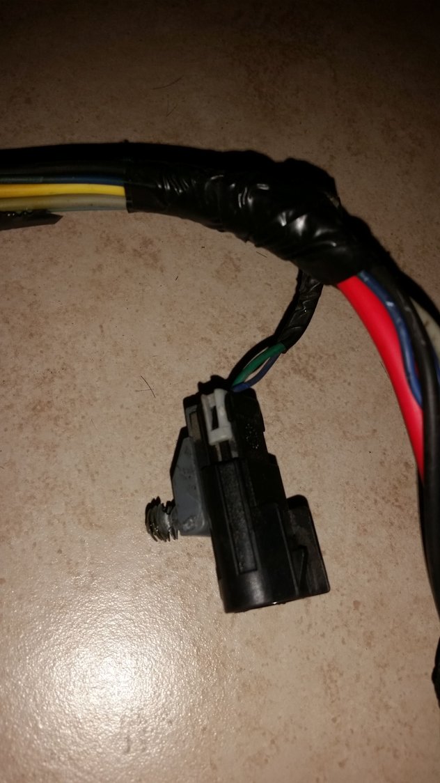

Had a quick question about the wiring on the efans, I was reading the write up on the link you sent me, I'm a bit lost I know I have to add a relay and splice into the green AC wire and use pin 42 in the pcm my question is where does the wire you plug in to the pcm contect to? And also there is a plug in the harness besides the 2 that plug into the fans, where do I plug it into? I attached 2 pictures. thanks in advance.
