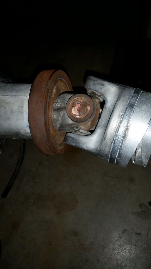

OK so I'm getting closer on slapping in the new motor , had a quick question about the yoke that comes out of the tail end of the Trans does that thing just slide out like the one on my 2000 4l60e, here is a picture

  #56
Wolftrk99's Avatar
Joined: Jun 2013
Posts: 5,492
Likes: 48
From: Virginia Beach,VA
Yes... That yoke just has a balance ring on it
Old Oct 11, 2015 | 04:38 PM
  #57
derocafela_1's Avatar
Registered User
Joined: Oct 2015
Posts: 30
I tried pulling on it, and I hit it with a rubber mullet It just won't budge, does it come off with the balance ring?
Old Oct 11, 2015 | 04:48 PM
  #58
Wolftrk99's Avatar
Joined: Jun 2013
Posts: 5,492
Likes: 48
Yeah but as far shoved in it as it is, probably gonna take a but ti get it out....hopefully splines arent twisted
Old Oct 11, 2015 | 09:07 PM
  #59
Registered User
Joined: Oct 2015
Posts: 30
That thing is not coming out I keep hitting it but nothing, going to call a transmission shop tomorrow to see if there is a trick to it or a special tool.
Old Oct 11, 2015 | 09:54 PM
  #60
Wolftrk99's Avatar
Joined: Jun 2013
Posts: 5,492
Likes: 48
That rong shouldnt be that close to the tailshaft... May take a wedge of some sort to pop it out, its a slip yoke, but over time crap builds up in the back end of it and im sure thats whats holding you up... Try getting the u joint off there should be a hole in the center of the yoke, spray some pb blaster or wd 40 in it and see that if it breaks loose then!!
