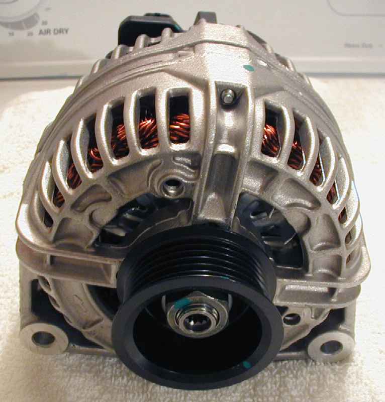

Behold the Chevy Tahoe Police Package alternator, 160A, no core charge.
Got it from a local dealer, for the same price that a certain online discount vendor offers it for: $138.48
For those looking to power auxillary items such as electric fans ('05 upgrade fans, H/E fans, etc.), as well as minor stereo upgrades, this is a nice piece of insurance.
This is a brand-spankin' new Bosch unit, not a rebuild (like the 145A alternators you pay the same price for, with an additional $90 core ).
Enjoy!
Attached Thumbnails More Power-160a-front.jpg   More Power-160a-back.jpg   More Power-160a-box.jpg

Thats the ticket. When I put my 145 amp in, I also considered running new battery and alternator cables to the junction box with the red cover. I didn't when I saw that they were the same part numbers for the 105 amp and 145 amp optioned trucks. You might want to consider with a 165 amp unit. I am going to up size mine after accidentally touching the wire from the alternator when the truck and e-fans were running. This cable gets damn hot.
