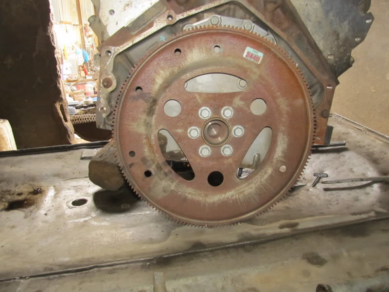

BTW can i use the flexplate upove on my 6L80 converter or should i use the 5.3 plate
