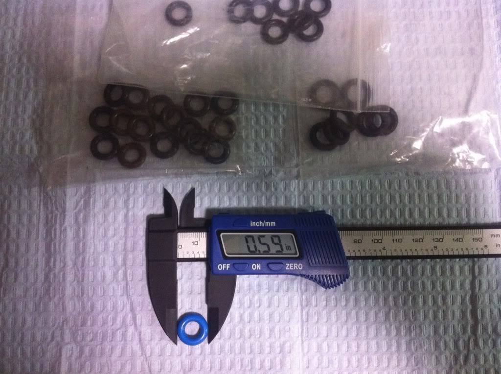

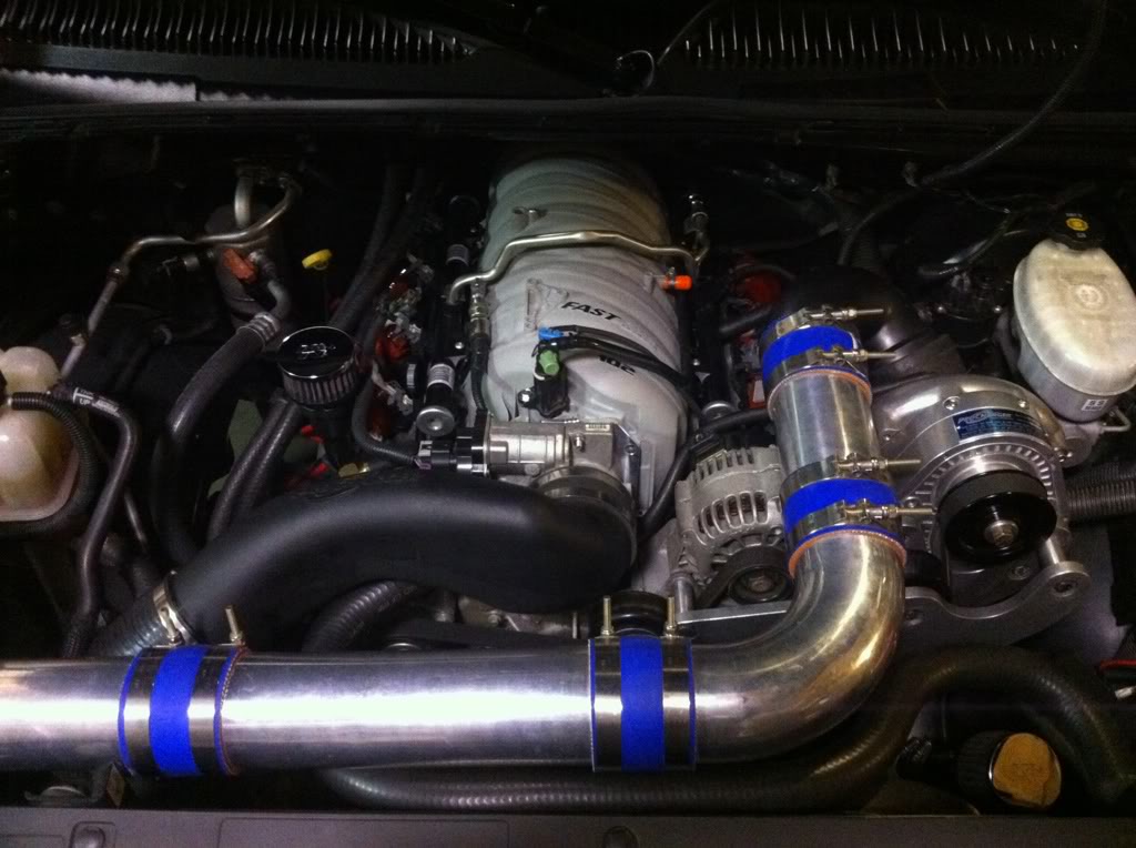

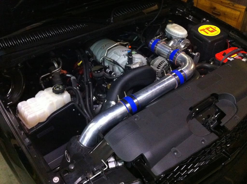

hey guys i finally finished up getting the lsxrt intake on but i have a problem....
where the fuel injectors go into the intake it seems i need thicker o-rings.
the blue ones i have now are snug but not real tight, after running my truck for a few mins 2 of them where leaking abit.
so i need help finding some that are abit thicker.

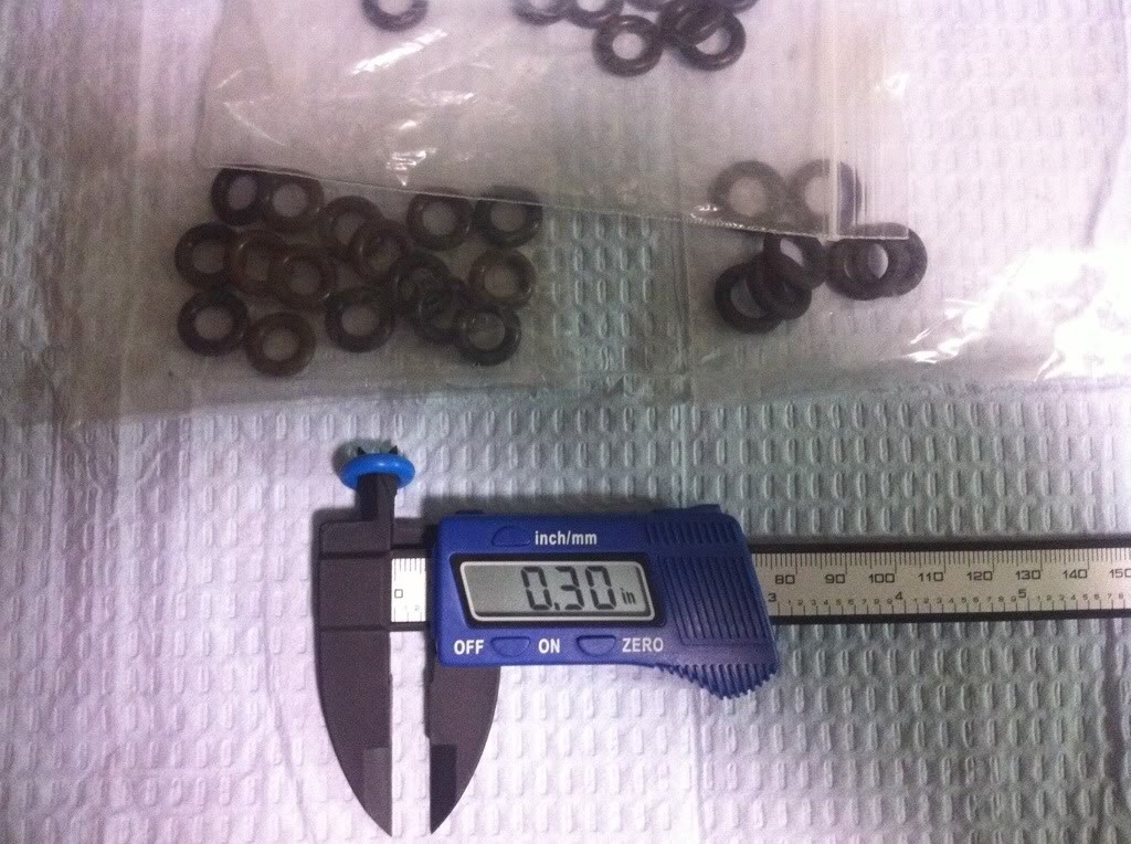

here is what i have now.
0.30 ID
0.59 OD
so i need the o-rings with the same ID but the OD needs to be atleast 0.62
if you guys know where i could find some that would be awesome.
Thanks.

Old Jan 24, 2011 | 01:13 AM
Boosted_Silverado's Avatar
Joined: Jan 2009
Posts: 689
From: Vancouver BC Canada
i think i found some off a evo i can use, they are .062 OD.
going to find out tomorrow what the ID is.....
