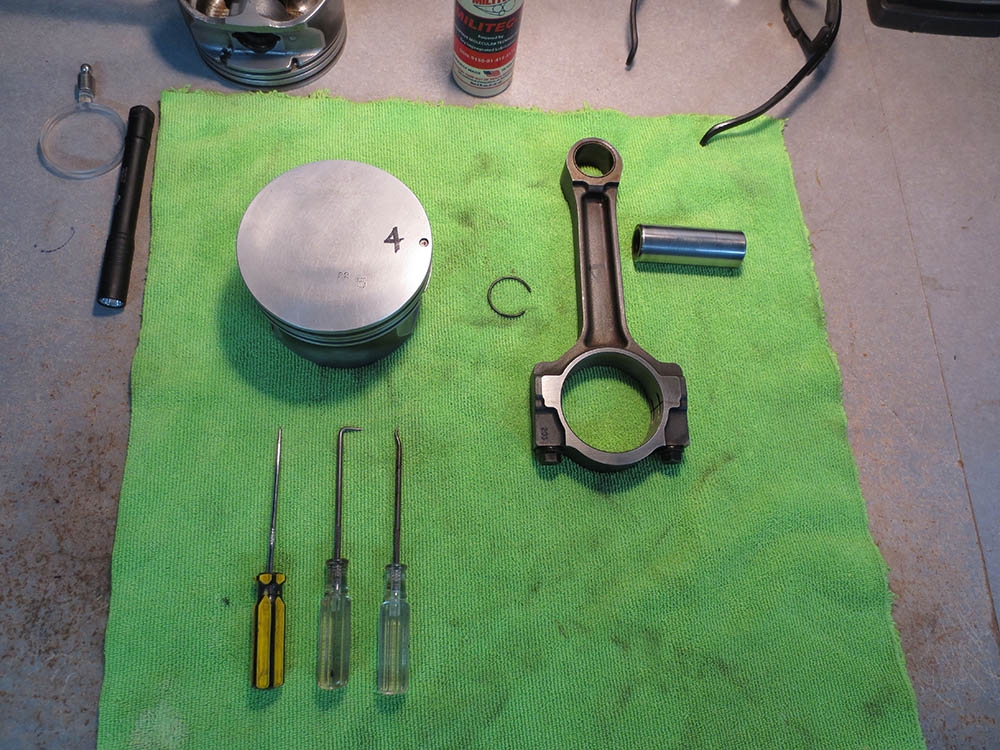

Correct on the camshaft specs. All LQ9's were equipped with the better rods with the dimple and floating pins even with the 99-00 iron head LQ9. The LQ4's had the better rods 2004+
I pulled and cleaned the 120,000 mile varnish from the pins & pin bore during my build. I trust these rods more than the standard GEN III rods... enough so I just upped the rev limiter to 7000 today after banging off the 6500 limiter earlier today
