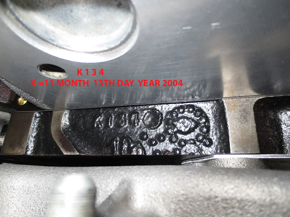

Originally Posted by 1994Vmax
All LQ9's ( started in 2002 Escalades) Easy way to tell is the block changed to the equal length head bolt in 2004 (calendar year)
I have the equal length head bolts on my "November 13th 2004" dated block out of a 2005 Escalade with of course the better connecting rods.
