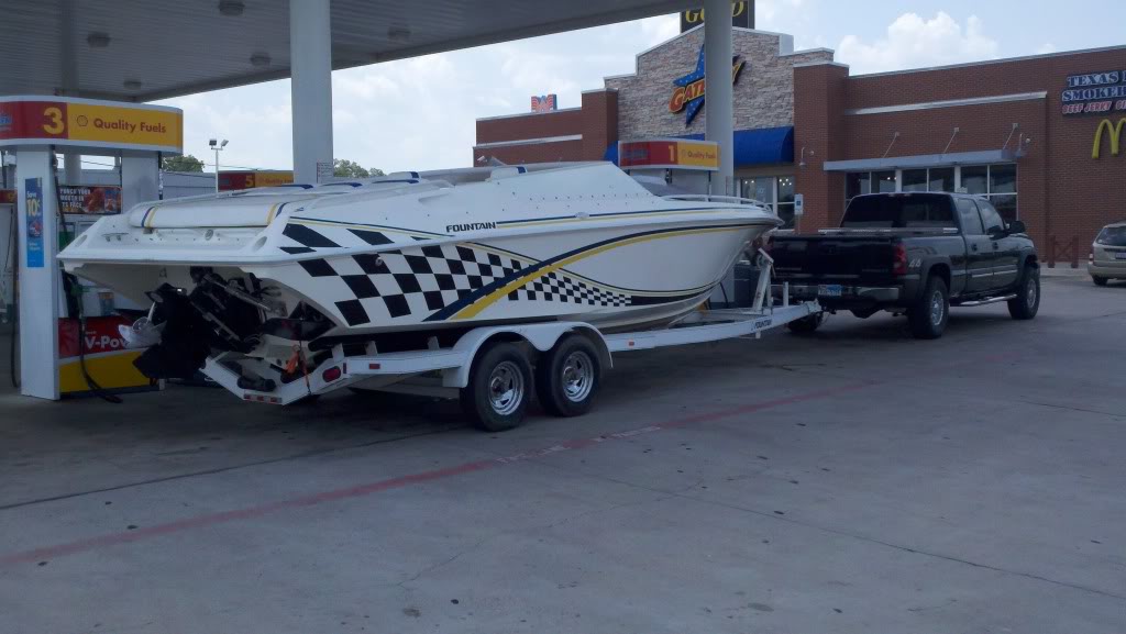

I went over board with my setup. The best cam that I have had is the 212/218 high lift with the stock 317 heads so far. I pull a heavy boat and 4 wheelers also.
Now I have a L92 heads/intake with a TSP Torquer V2 cam, 3K stall, LT headers, 3.73 gears, and 285/75/16" tires (33's) It gets better than stock fuel mileage, and it's still fun to drive, even when I'm pulling the boat. There's a few vids of it on youtube
