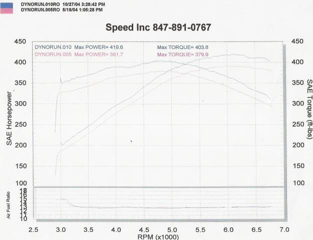

You mean like my 210/218 ~.570" 112LSA?
I would be running around ~.590" if the .551" cam was available when I bought this one. (It's .531" w/ 1.7's.)
The ramp rate is accelerated via the rockers.
This cam makes torque EVERYWHERE. I'll have new track numbers April 1st.
Here is a dyno from another member's Z06 with this cam, Pats StageII heads, and the usual bolt-ons.
This is something that I believe Lingenfelter started doing in the LS1 motors. Some of their early "secrets" was running a fairly mild duration with a higher lift and custom rockers in the 1.8 and 1.9 ( ) range. This kept the motor "drivable" and able to make necessary vacuum, yet still have the advantages of higher lifts.
