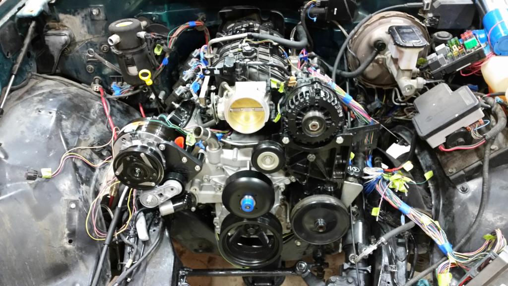

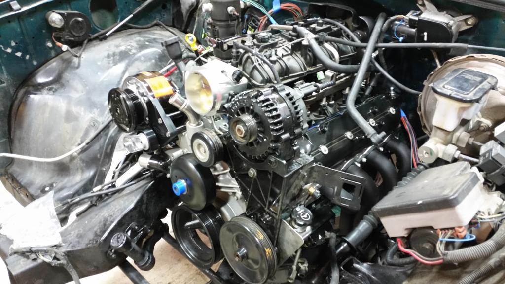

And because I am a pic *****:
Injectors in question:

Thats a good lookin set up. Nice install. Shop air should work. Just regulate properly. U can use a can with a hose in it to push the cleaner through the system.
