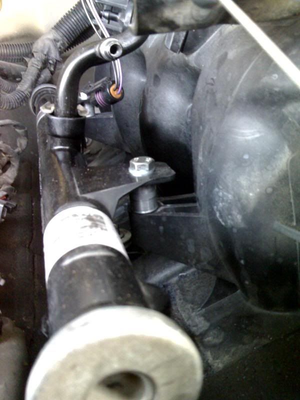

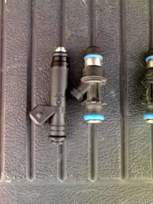

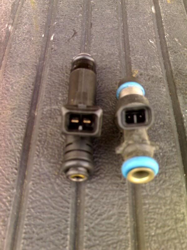

Pigtails are for the connectors. Not the same as multec II. I got mine from a junkyard about $1 each. Just cut crimped and soldered. Spaced 5/8" exactly going from stock injectors to 60# mototrons w/ stock rails and intake. I cut the spacers out of aluminun tubing from Home Depot w/ a tubing cutter.

sweet pics man, thanks alot. i believe the radix injectors are the same. so i think that should work fine. those pics are worth a thousand words. thanks man.
