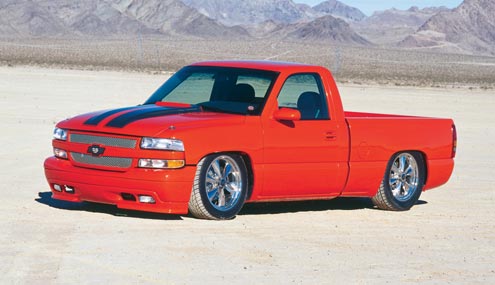

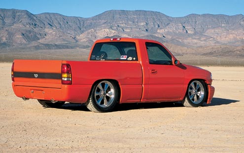

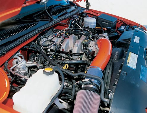

Here's that truck that was customized!! It has the 496ci and also the 4l80E tranny. Really nice love the Hugger Orange color!Also has air ride!! If i could offord it i would swapt my 5.3 for the 8.1L always loved the big blocks good power for the 496 310hp and 520Tq!!!!

Here's that 496ss bitchin truck!!! Gots the 8.1L and the 480lE tranny also has air ride.If i can offord it i would do the swapt and built that 496 into more power!!

....i remeber reading on the truck i loved it but i couldn't ever find it.Man i love that truck
