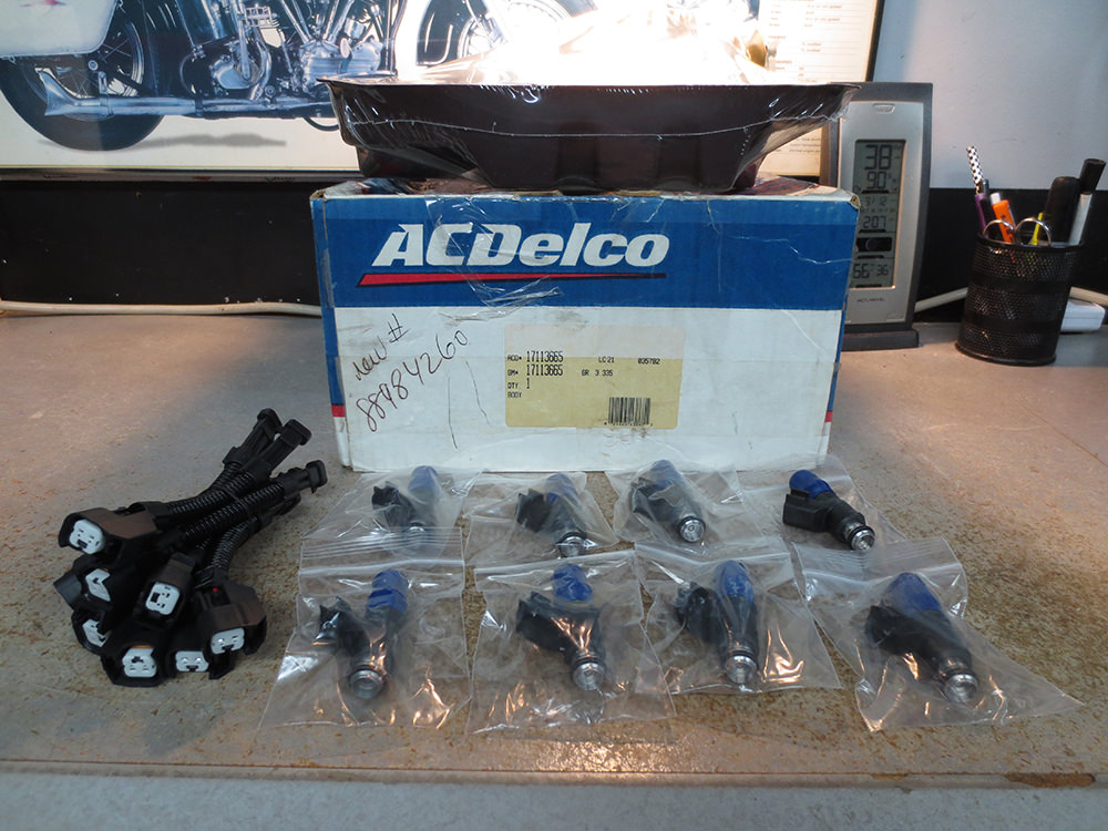

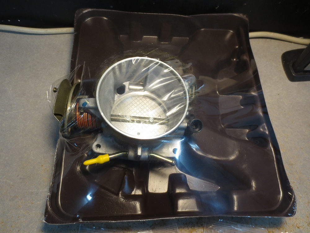

I found a new (New Old Stock) ACDelco on ebay with sensors, still in the beat up box, for my truck, $75 shipped
