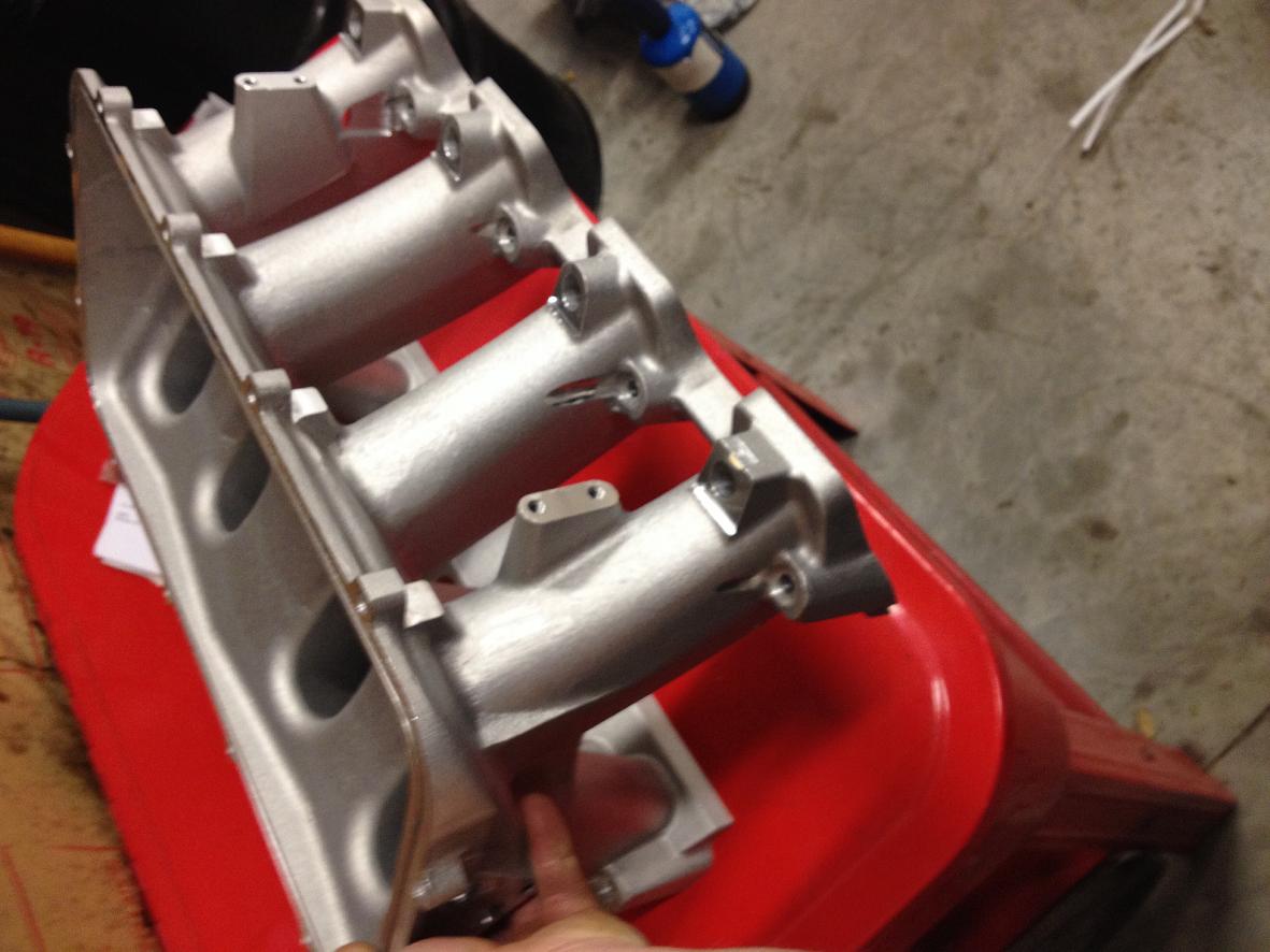

The mid rise is a dual plane intake vs the single plane hi rise.
Has anyone seen the mid rise intake without the top plate on? Its pretty cool looking
I think you nailed it on this one...
Results indicate a single plane vs dual plane has a larger effect than runner length.

Since people keep saying it here is mid rise...

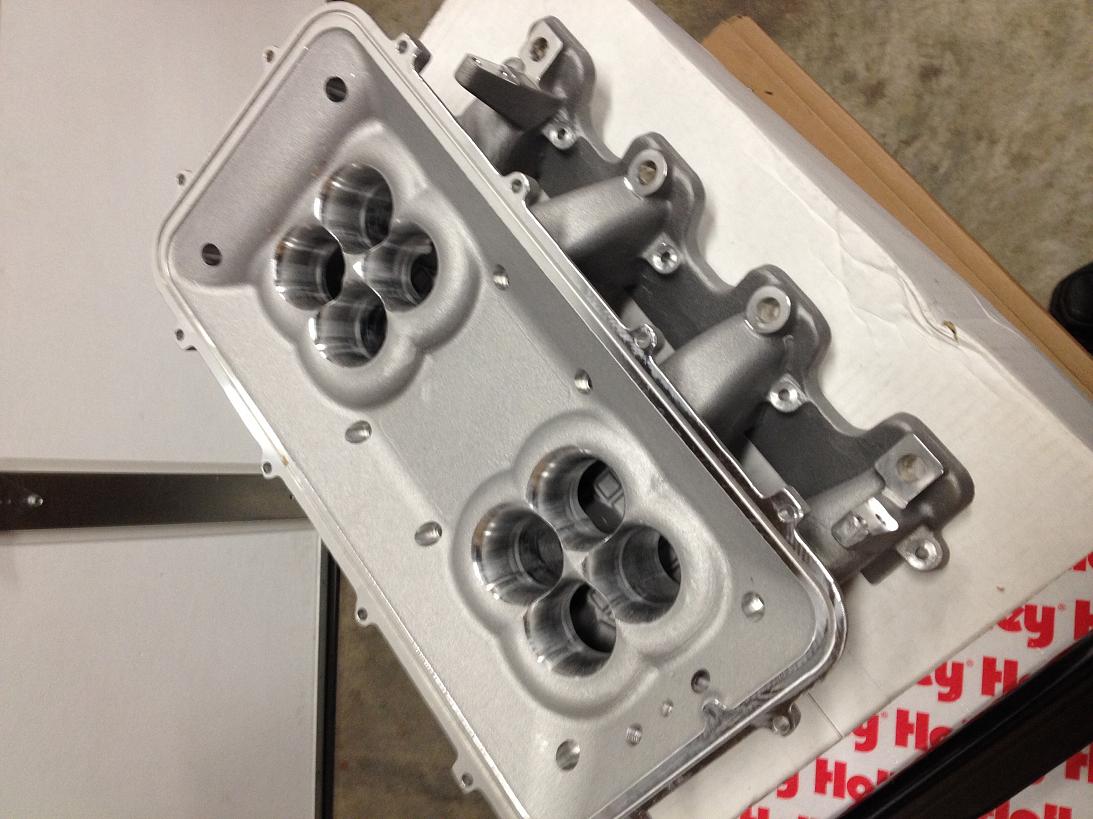

And here is the high rise. Holley will have mid rise ls3 intake this 1/4. They currently have just the cathedral. I bought both...

wouldnt a dual plane intake call for a different cam that a single plane??? which makes the results useless there are cam companies on tech that claim that with the correct cam, a single plane can have the same low end as a dual plane with the up top gains that are typical of a single plane. lower ICL to encourage higher velocity (or some **** like that lol). which is my my single plane setup is 110lsa on a 106 ICL vs a typical 112-114 lsa on a 108-110 icl of a dual plane or gm efi intake.
