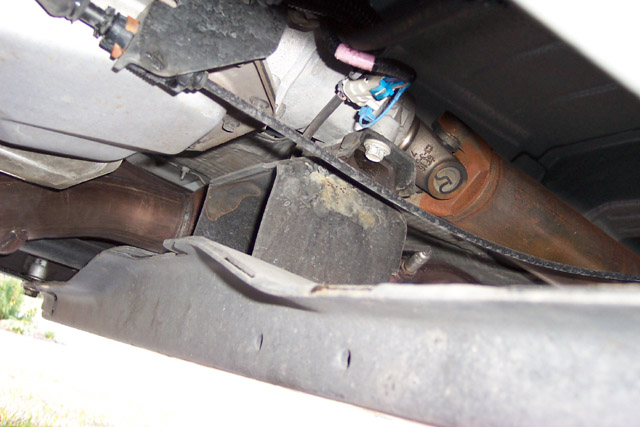

Can anyone take pics of a 2500 LD 4l80E crossmember? Preferrably 2WD RCLB.

sure...t's a 2500 LD 4L80E 4wd ECSB crossmember though....but the crossmembers should be the same for the RC and the EC.......

Here is a picture of the crossmember in a 1500HD. It's the same as the 2500 models. The 1500HD IS a 2500 model made for people that don't want a "3/4 ton" truck.
This picture was taken by L82gofast.

XLR---hmmm, I'm guessing that's a 2WD. Wonder if it would really be necessary to get that crossmember for the swap?

as easy as it is to bolt on to the frame I would get it....even if you have to drill some new holes in the frame to mount it.......it looks ALOT beafier than the 1/2 ton crossmember that parish8 modified

That's what I was thinking. The tranny that I'm looking at is a 2WD tranny, so maybe they'll have the crossmember off of that truck too.
I'm going to run by the dealership tomorrow and start gathering some part numbers for everyone!
