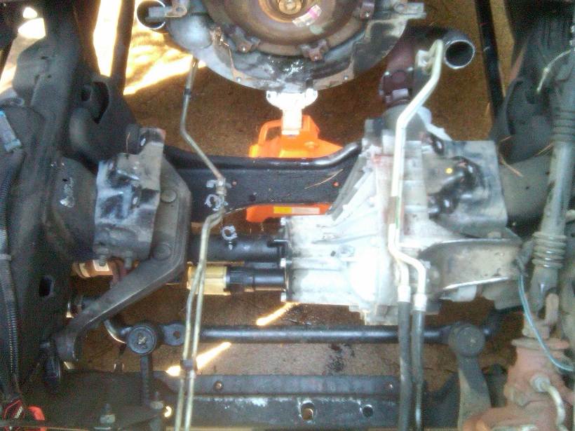

yup, this is pretty much the same procedure I followed
There is no need to slide or move the trans anywhere. Also don't touch the transfer case. Just use 2x ratchet straps to prevent the tranny from moving forward when you pull on the engine. And put a jack stand under the bellhousing as shown below.
Also, you don't need to remove the radiator. Just be careful and don't smash it with the engine.
