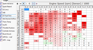

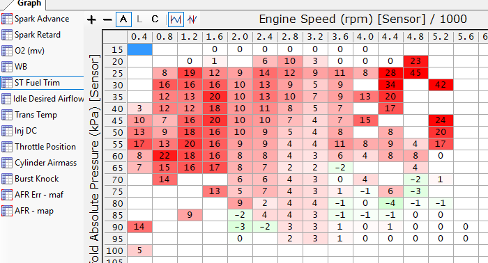

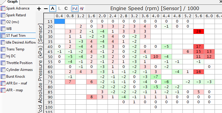

Here's what the VE table looked like.
1st pic - short drive right after the cam install
2nd pic - 1st correction + short drive
Attached Thumbnails Had a rough couple of days.....-2018-09-04-10_06_45-window.png   Had a rough couple of days.....-2018-09-04-10_07_12-window.png
