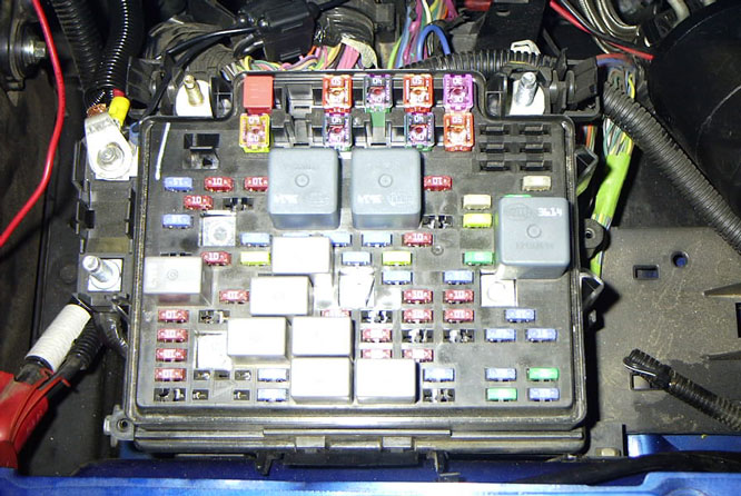

hey everyone*********HELP***********
Which wire is for the ignition for the Flex-A-Lite Fans
The Fans will not turn on no matter what temperature the truck is.
I hooked up the terminal # 9 to the battery and the fans work fine but I need to fine the ignition wire??
Which wire is it ??????
*****ANYONE*****

are you wanting to know where to hook it up in the truck right? i hooked mine to a terminal in the fuse block under the hood. i hooked mine to the relay terminal. if you are standing on the drivers side and remove the cover. on the right hand side of the box there are 4 holes where a relay could go. the right side closest terminal is ignition. good luck.

I have a photo that I just added right now

02 - can you take a pic of where you hooked it, sounds like it might be simpler.

yay here you go.
i left a little extra wire.

Here's other photo. I think I have other fuse box then your.
Here a better photo

yes you do. start checking them empty fuse holes for an ignition source.

well if you find out let me know.
THANKS!!!!
