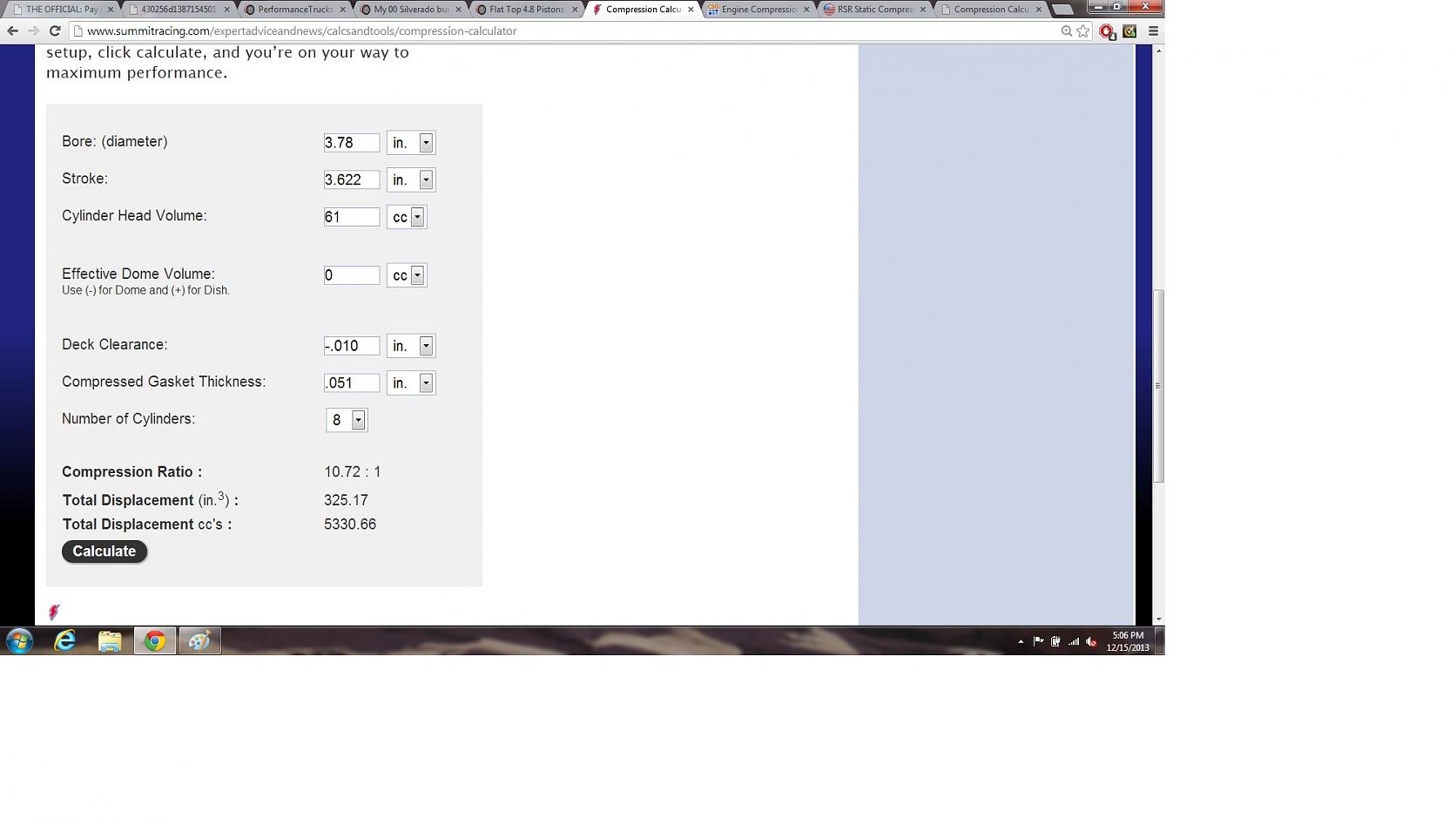

Old Dec 15, 2013 | 07:08 PM
  #38
1FastBrick's Avatar
Custm2500's Rude Friend
Posts: 14,597
Likes: 902
From: JunkYard
Originally Posted by AGearHead4Life
The one on Summit lately.
Do your values look like these?
Attached Thumbnails Flat Top 4.8 Pistons into my 5.3 HOW TO Video Here-summit-calc.jpg
  #39
AGearHead4Life's Avatar
Joined: Jan 2010
Posts: 669
From: Huntsville, Alabama - SA, TX is home
From Wiki:
"The Vortec 5300 L33 (VIN code "B") is an aluminum block version of the LM7, and was referred to as the Vortec 5300 HO in marketing materials. How ever it should be noted that the L33 uses a flat top piston from the 4.8L instead of the standard dish piston found in the LM7. This increased the compression from 9.5:1 to 10.0:1."
GM Vortec engine - Wikipedia, the free encyclopedia
Old Dec 15, 2013 | 07:11 PM
  #40
Joined: Jan 2010
Posts: 669
Yes, except for deck clearance. I used .006. I've heard they range from .006-.010 and i tried a few different values there. It made very little difference.
