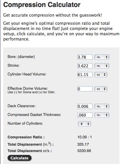

Yea, i've heard both on the dish cc, but haven't measured myself so I went with the lower number since they claim the same CC on the lq4 piston. I think I'll go out and measure tonight. those numbers are so close that I'd imagine it'd be difficult to get it exact. What compression calculator are you using? That sounds high. You're going to make me rerun the numbers and post up a pic of it...

Default Copmression ratio
Here is how I came up with the compression ration and the numbers used. This is using a MLS head gasket with a .060" compressed thickness. One photo is stock and one is with the 4.8 pistons.
Attached Thumbnails Flat Top 4.8 Pistons into my 5.3 HOW TO Video Here-53-mls-head-gasket.png   Flat Top 4.8 Pistons into my 5.3 HOW TO Video Here-53-48-flat-top-pistons-mls-head-gasket.png
