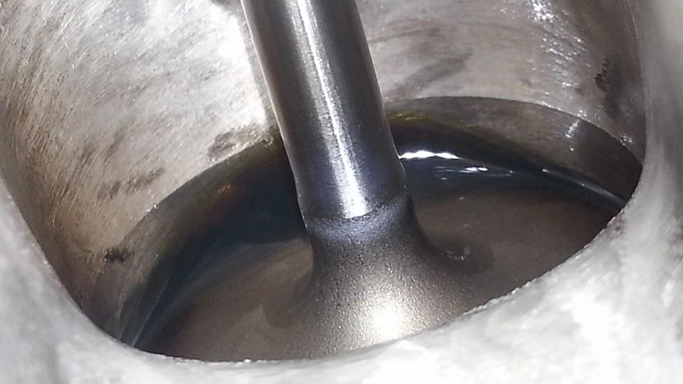

The truck is still running great and I daily drive it to work everyday. No issues beside my tune not being complete (since I pieced it together) and #2 seems to be burning a little oil. Not enough to foul the plug, but enough to leave a burned white crust on it. It also gives a puff of smoke on start up. Especially after running it hard, it seems. Hard to tell since I run it hard pretty often.
At first I just figured it was because I reused those 165k mile piston rings (which would be expected) but then I found that the oil was on top of the intake vavle. So that drew me away form thinking its the rings. I had pulled the intake for something else and found that the #2 cylinder intake valve was closed and there was a puddle of oil on top of that valve. #2 is the only one burning oil.
The only ways that I can think of for oil to get on top of the intake valve is that:
- Leaking oil out of the rocker bolt hole that I cut open when porting.
For those of you that don't know, it is normal to cut into the threads of the rocker port when porting your heads. I thought it was sucking oil down the threads at first since I hadn't use thread sealer, but I've since RTV'd the bolt threads and still have oil burn. So I don't see how it could still leak.
- Oil blow by from the PCV system and sucked into intake
I doubt it's the PCV because that is at the opposite side of the engine than the PCV vacuum port. But I do have the normal excessive oil coating the inside of the ports from the PCV. So I swapped out to the LS6 valley cover and PCV pick-up to reduce that. I plan to install a catch can also.
- Bad valve stem seal (praying for it to be this one)
I plan to change out the valve stem seal soon.
- Bad valve guide
Valve guide will be a last resort.
I'll update after I change out the valve stem seal or once I find the source.

I would bet on the valve seal my self...
Try using Valvoline Max Life for high milage engines and see if it reduces or goes away. My 2000 did this at 80k and was burning 2 quarts of oil over 2000 miles. I tried this as a last resort and It now has 165k+. It only smokes on start up if I run the **** out of it hard.

Default Oil on Valve Pic
Here's a picture of that coincidental moment when I found the intake vavle closed on #2 and a puddle of oil on top of the valve. I was surprised to see this.

From: JunkYard
Damn! There is your smoking gun...
Yea, I just pray its not a guide and only the seal.
Although I don't work at an engine shop so I don't have first hand knowledge. I believe the Valve guides are Powdered metal. There usually pretty durable so unless it's bent a valve in the past or had alot of runs with no oil I doubt the guide is bad.
It seems more common for the valve seal to get damaged during installation.
It might not hurt to have a machine shop look over the stems and guides.
The guides may need a hone and the stems may need a polish. But I'm still certain the seals are the root cause of the issue. Did you thoroughly lube the valves when you installed them? Something more than runny assembly lube?
I believe its a common practice to use white grease or something grease like with a high pressure rating to protect them on startup as Oil will get wiped away real fast.
