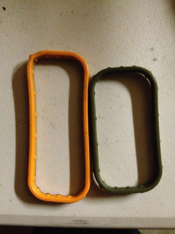

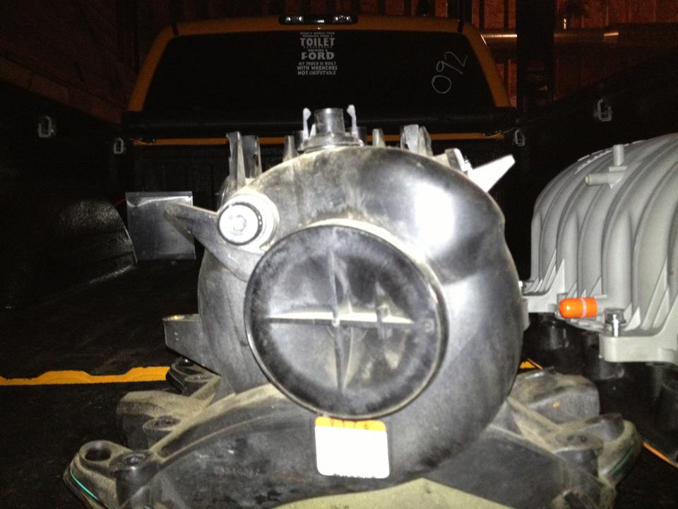

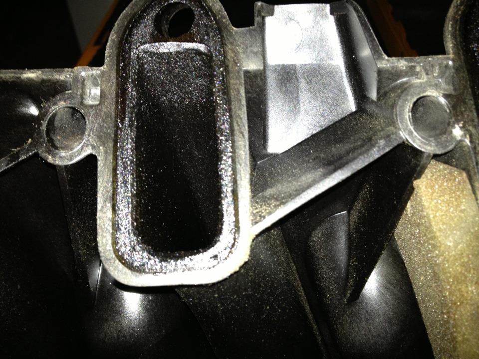

just figured id post this since ive gotten some questions about if im running a rectangular port instead of a cathedral port and were the brake booster port is to supply the booster with vacuum
cathedral left rectangular right
LSXRT INTAKE PORT
STOCK TRUCK INTAKE PORT

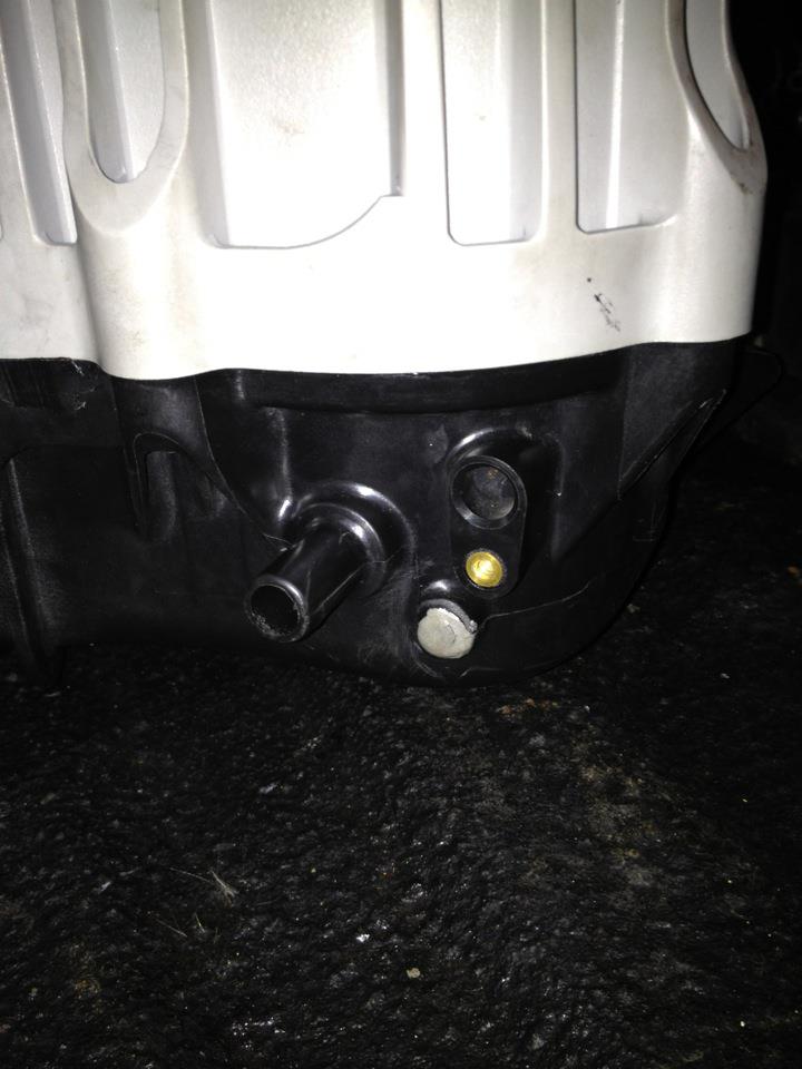

as far as were the brake booster port is its mounted on the stock intake here at the top left of picture
the brake booster port on the LSXRT is down the bottom right of the picture

Good ole JB weld. So your no useing that port for an FPR? I have mine hooked up to the FPR, I know boosted applications do this but someone else on the forum said that it would not kill it. Also I wanted to see how the catch cans are hooked up.

reason that got blocked off is the nipple was busted off during shipping and im using the stock FPR setup with stock rails

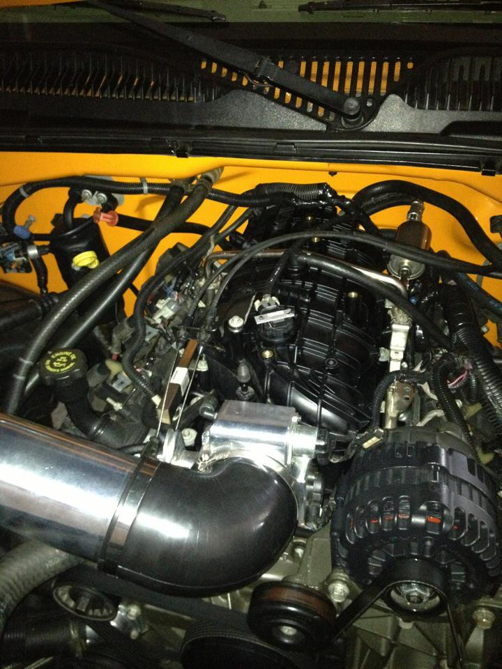

well figured id update this thread on what i ended up doing i got a really good deal on a TBSS/NNBS style intake from a member truck runs pretty damn good still gotta be tuned its running pig rich but otherwise im happy.

definitely better threw the whole rpm range over the stock 78mm setup and its not even tuned yet

im pretty sure its the tune but i just got tired of pulling the intake off so i just did the TBSS/NNBS setup and so far im very happy with it
