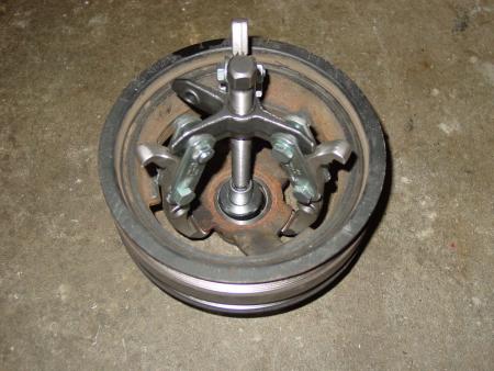

Here is how to hook the puller up. I wasted alot of time trying to hook it to the other tabs on the outside which doesn't work at all.
Now that you snapped one of the tabs off you will have to come up with something else.
