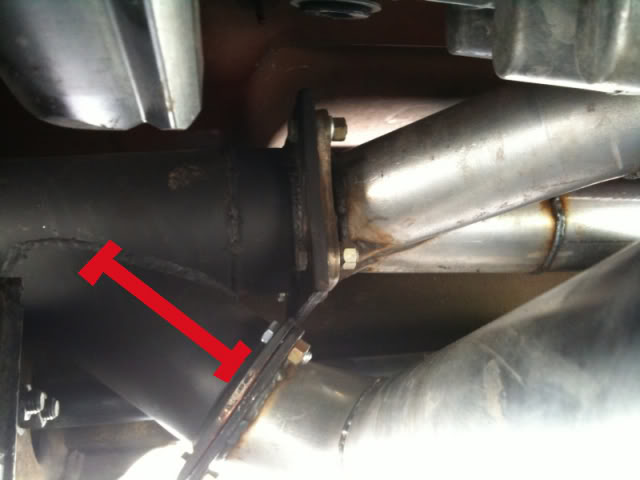

Well, i tried it...
...and it didn't work
. Calculator said I needed 1.8 feet to move the res frec from 2200 to 4000, so I made this about 1' 10" and bolted it to the cutout. Truck STILL has the same drown above 70 miles an hour.
less then 70 it nice and quite, then 70-80 (most of the highway driving I do) it almost doubles in volume in the cab. Really bummed about this, my ears are ringing when I stop after driving for a few hours...
Any ideas? did I not do something right?

Well it sure looks nice. I have a question KBracing. You made the length of the pipe you added from the flange to the capped end 1'10" right? Im thinking you forgot to take into account the length of the cutout, my guess is 4 inches or so looking at the picture. Here, check out the picture below, I highlighted the area im talking about in red. So maybe try cutting off the capped end and shortening the resonator by the amount of how long the cutout is (length of that red line).

Yep, I included it. It's about 4 1/2", then I measured the bend along the center line of it, so it all came out to about 1'10" or so. The thing that has me most discouraged, as that it didn't seem to make any noticeable difference.
