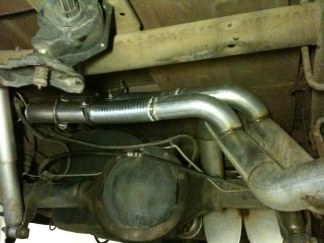

I'm still thinking the tailpipes are the place for the resonators. That might be tough for you on the right side pipe. There still might be room if you can come out of the top of the right pipe just after it goes over the axle and 90 to the left before it hits the bed. On the left pipe, you could come out of the side of the pipe easily.
Here's a pic of mine taken from just behind the left rear tire. Again, I have a single 3" tailpipe. I used 2 1/4" pipe for the resonator, but I don't believe diameter is critical within reason. I bought the 304 stainless flex tubing from carparts.com, $35 for 5 feet.

Murphdog, your setup hasn't changed right? Have you tried taking the resonator off, and testing back to back the noise level when driving? Im just wondering how noticeable of a change you are getting out of your setup.

TS77, no nothing has changed other than I changed the original aluminized setup to stainless and replaced the hose clamps with Torca clamps. The pipe diameter and length remain the same and both the aluminized and stainless versions work equally well. I have not taken the resonator off since I put it on. Noisewise, I don't believe the exhaust volume changed at all after I put the resonator on. The resonating noise I had at 1600-1700 rpm, however, is completely gone...no resonance at any rpm or load now.
I wish I knew the answer to how this works on other than a single muffler/single tailpipe system, but I don't. I know the Mustang guys reported success with two 24" resonators on their tailpipes.
Before I bought the Magnaflow system I have now, I had a local muffler shop put on a single in/dual out welded Thrush muffler and dual tailpipes. It droned bad as well and I thought about experimenting with the resonators on it, but didn't. It was too loud and the noise it made when switching from 8 cyl to 4 cyl was really obnoxious. I cut it off after a week once I had the new Magnaflow system. Besides, it looked like a 4th grader had done the welding. I doubt it would have lasted a year before it fell off.
