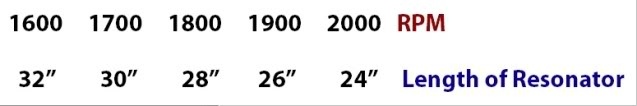

Also keep in mind that the auto lounge calculator is designed for actually cutting or adding length to the exhaust pipe, not a branch resonator. But for some reason it seems to work for the branch resonator too. Like Murphdog said, the length doesn't have to be exact. But what seems to have proven to work are lengths between 24" and 32". The shorter the branch resonator, the higher in the RPM it will cancel drone. The longer the branch resonator, the lower in the RPM it will cancel the drone. I actaully just noticed something very simple. Ill draw up a picture and post it.
It looks really simple. The mustang guys were using 24" branch resonators at 2000 RPM drone so that relationship is correct, and Murphdog is at 30" around 1700 i believe he said (correct me if im wrong). The rest of the numbers just fall into place.
