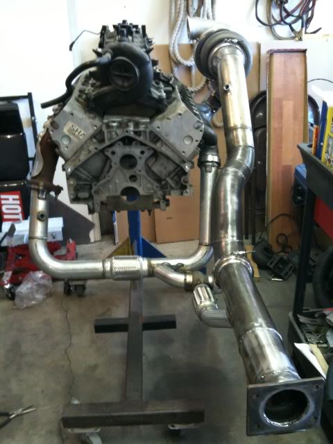

OK, so doing a little more driving with my truck and playing with it, here is how it drones. 2000rpm, no drone, I like it----2500rpm twice as loud with drone----3000rpm, no drone I like it too. 2500 is about 77-78mph, right where I like to run in the highway. What kind of suggestions do you guys have? I really can't make the pipe I have longer, cuz it will have to be lower (less ground clearance), or it will run into the t-case, but I was thinking maybe a pipe in a pipe like the Corsa has??? How long you think I should need for that? Any ideas on what to try next?

It's 4" off the turbo, back to about the end of the transfer case with a 3 1/2" cut out right before the 4" ends. Then it splits into duel 3" with 2, 24" center in, offset outlet Magnaflow mufflers, then over the rear axle and exits at a 45* angle out the pass rear of the truck. Here is some pics.
Any suggestions you may have would very much appreciated
