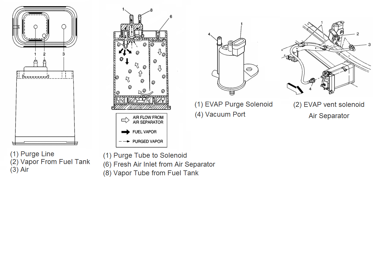

For those who have removed this system, How did you go about?
Looking at swapping to a smoothed truck intake this weekend and eliminating the complete evaporative purge system at the same time. When doing this the only thing to consider is the vent for the gas tank. Feedback on not removing will not be entertained by me, it is coming out.
Thinking I have two options to vent tank. Either a vented gas cap or leave the factory cap and just vent the tank.
In the first two pics #1 is the vent tube, This tube has a tee, one is a vent to tank and the other looks to be a vent at the fuel pump housing.
Couple question on which way to go about. The rear end vent routes up to the fuel filler cap. Would it be safe to tie the #1 tube in diagram to the line for the rear end vent or just route a new tube from #1 to gas filler location? Can I plug what I think this is a vent at fuel pump housing and just vent tank?
Not sure if the gas tank is suppose to maintain a certain amount of pressure, if so going that route may be a problem?
The other option is plug the #1 tube in diagram and just use a vented gas cap. But what kind of gas cap to use? Do vented gas cap work the same as a radiator cap to where they maintain a certain amount of pressure? What has me thinking this is the code you get when gas cap isn't tight.
Am I just over thinking this? Vehicle is the '99 in sig.

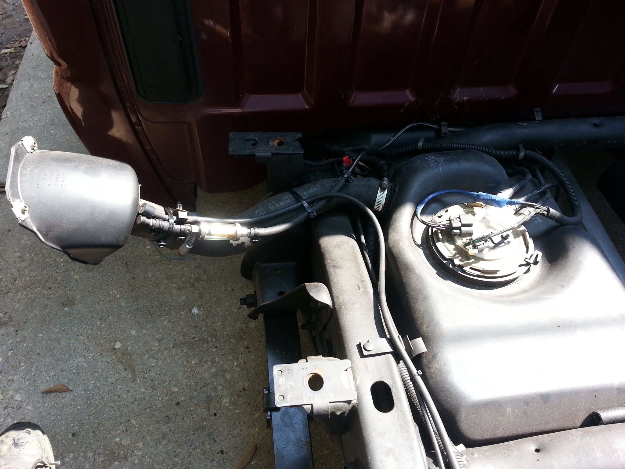

Removed the #1 line in the first pic in original post from the canister and slipped a 3/8 rubber hose on it. Rubber hose routed up to filler neck with a glass filter and vent cap.
After reading this thread https://www.performancetrucks.net/fo...ations-530099/ I thought I may have a problem with the way it was so first thing I did was go to the gas station and filled her up from a 1/2 tank with no problem reported.
Plan is to remove the filter from the glass housing and fill it with some activated carbon from the pet store to see if helps with fuel vapor odor. If that doesn't work out thinking of making a canister out of clear pvc with caps that I can tap 1/2 thread into to make a higher flow one.
