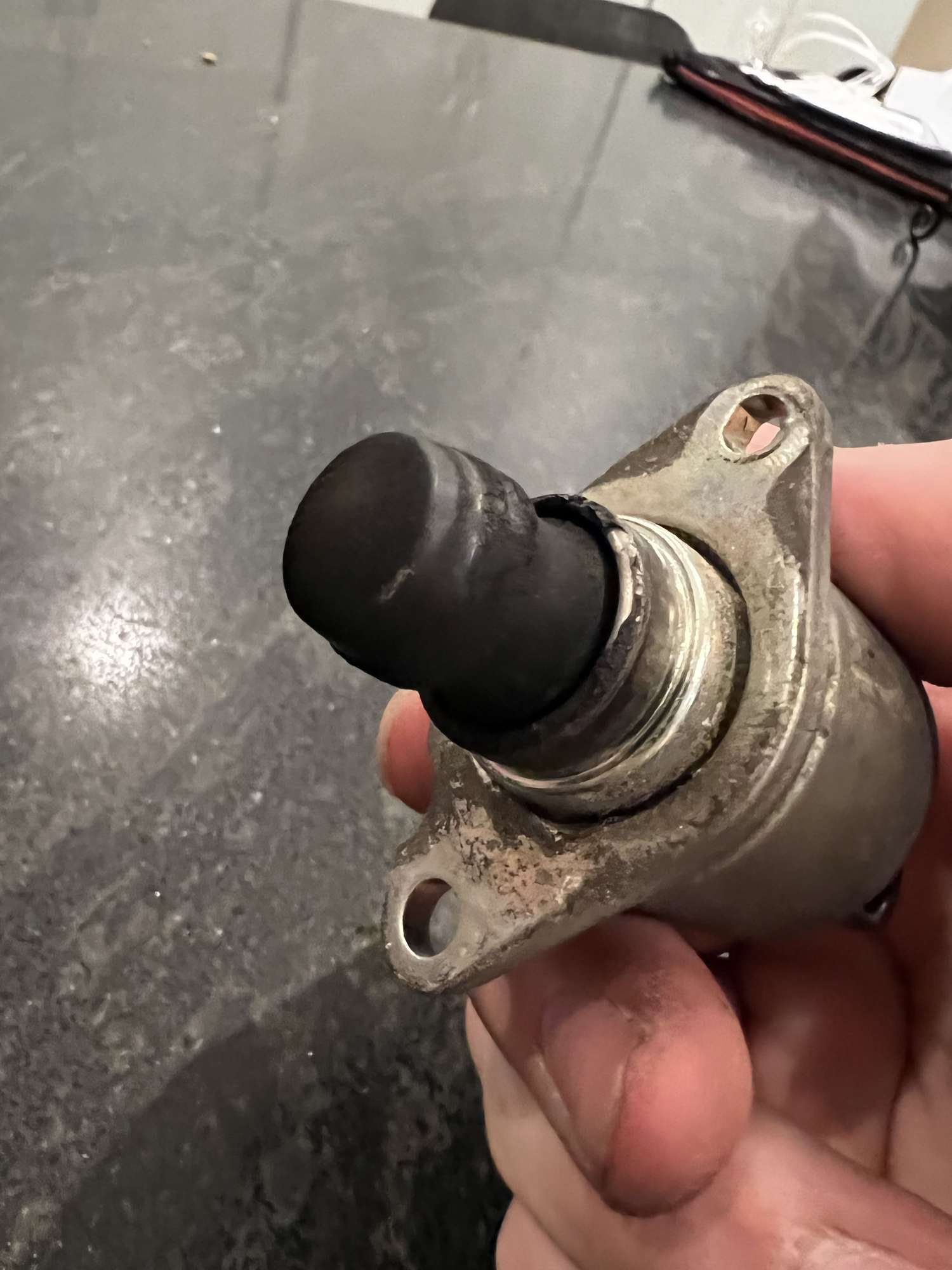

Stop messing with the MAF. You are more likely to contaminate it.
Look in the IAC passage. Pull the IAC valve out and check to see if its gummed up.
I don't know why I pulled the map sensor. I had meant to pull the IAC valve lmfao I will do that tonight kill me irl please.

IAC sensor. Looks a little dirty and gummed up to me. Throttle body cleaner and wipe out the port for it?
