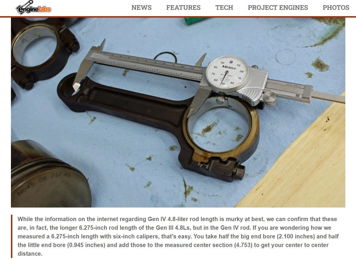

Just to further illustrate how J&E is wrong, This article shows how they measured and confirmed the Rod length of the 4.8L is 6.275
https://www.enginelabs.com/engine-te...ine-the-ls5-0/
Last edited by 1FastBrick; Sep 15, 2023 at 08:29 PM. Reason: added image of proof from article.
