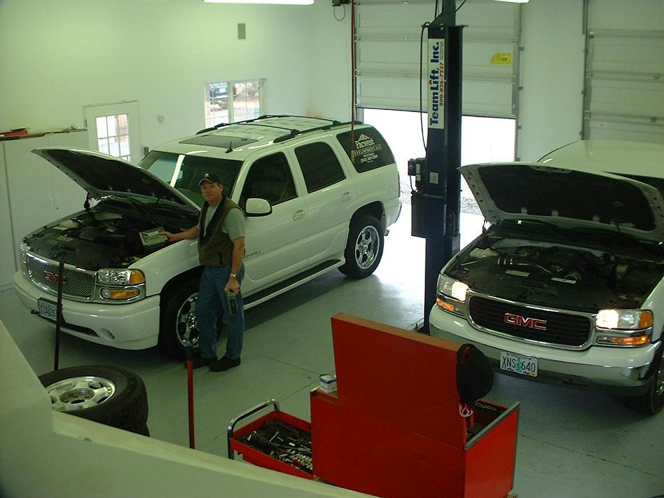

His Denali runs awesome with the mods we did.On his we did a yank 11" 2600.My buddy did some towing with it.I would say something like 5kLbs. for approx. 300 miles.His trans fluid was dark after that,before that he had towed and never discolored the fluid.And with the weight of this vehical you can feel the stall.All I know if it was me I wouldnt go anymore than 2600 stall if I was going to tow.But thats just me.
