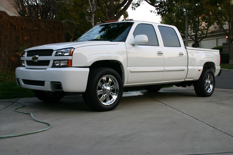

I've got an '04 Silverado 2500 Crewcab with the 6.0, I've always thought the truck was a dog for a 300hp rated engine. I've got a Wester's Hot Tune 91 computer upgrade, that helped tremendously. I've held off on a muffler because I want one that is silent unless I get on it, and Corsa doesn't make one for my truck, I'm looking at the FloPro 2503. But I feel there's more untapped power in this engine. I'd like to change out the cam to something a little more agressive, but since I live in California, is there a cam that will give me more power, but stay emissions compliant? Or do I live in a fantasy world? After all I need some go with the show.
