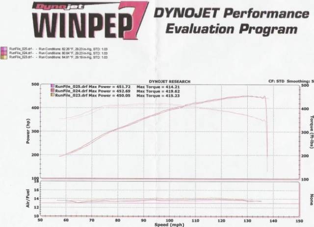

I know it is possible. I made 452 rwhp and 419 rwtq on a stock LQ9 with a custom grind comp 232/238 595/605 on a 112+2 this was through MAC midlengths and dual exhaust. Only major difference is I have a T56 tranny and a 12 bolt. Dyno was on 29" drag radials.

Originally Posted by BigTex
FirstGen - do you have a truck intake on there?
Truck intake, home ported TB, truck MAF descreened, open element cyclinder style K&N filter. 8.1L injectors.
