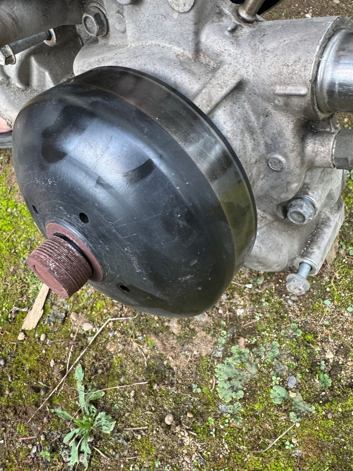

It def is, they break rite where that weld is.. Or twist off of that hub shaft because they flex and break where that new thicker weld has been added..

I ran a bead of 7018( stick weld) around my pulley/shaft. It aint goin no where now.

The pulleys dont usually shear off, they get pushed off the shaft by wider belts. Run a weld bead around the inside of the pulley snout where the shaft is sticking out.

Default Water pump pulley on 2021 Chevy Silverado Trail Boss @92km
Originally Posted by AKlowriderZ71
Please post up your pics of broken water pump pulleys. Thanks!
