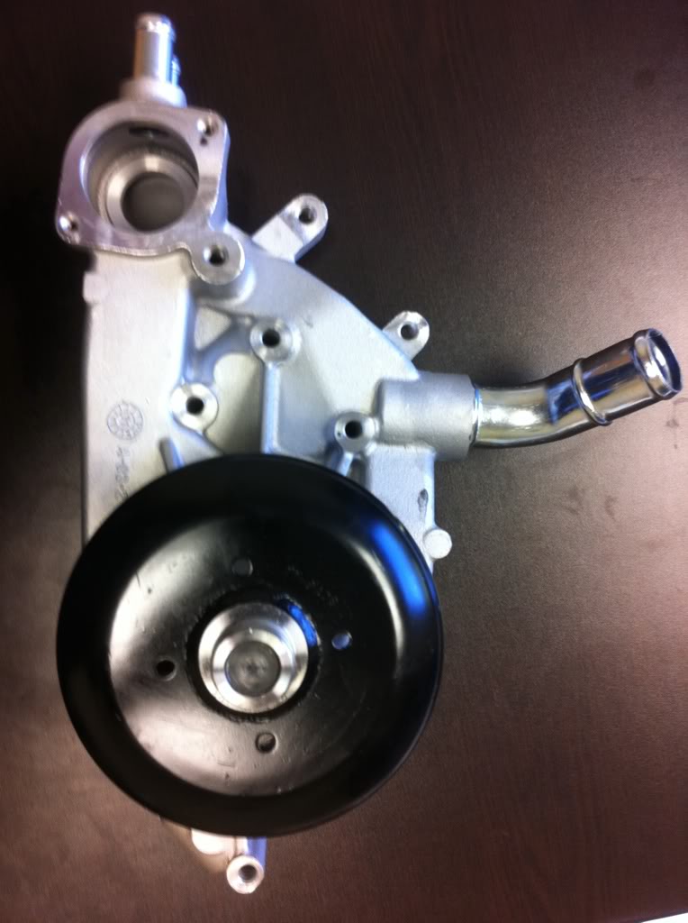

Nope. Just wanting to see where/how they break. My Yukon pump started leaking out the weephole last week. I replaced it with a new pump from Carquest, and the pulley looked to be improved over stock. I wanted to see some stock broken ones to compare.

All the ones I have seen sheer off right at the are around where they are attached to the shaft

Thats it, that will fix thee issue of twisting them off

Originally Posted by andrew383
https://www.performancetrucks.net/fo...9/#post4742082 about half way through the first post..Check his other post in i think Timz's thread a few days back..
I saw his pic, and that's what got me wondering. I've never seen one broken, except for pics. Even then I didn't pay much attention. Now I just want a closer look of as many pics I can get in one place.

It has been welded, is not just the reg casted pulley.. So if that is the new style part of the issue was addressed.. Alot of guys were welding or tacking them to the shaft because they were twisting and breaking off where they seated..

It looks to me like the "hub" they used on this new CQ pulley is thicker than the stocker, which hopefully makes it stronger in the area of prior breakage.
I'm hoping to see more pics of broken pulleys, to see how thick the metal is where they break.
