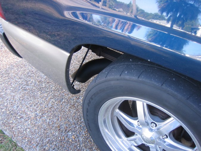

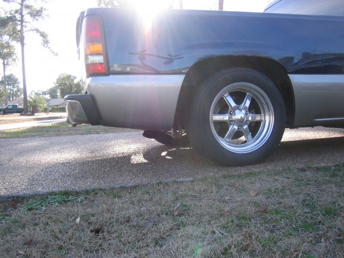

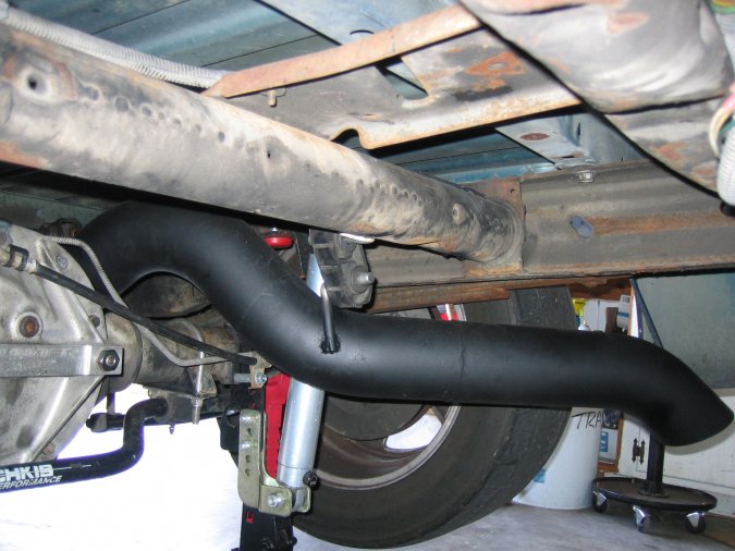

Food for though... this is how I did my tail pipe cutting/welding from the Edelbrock d-max kit.
I would also recommend getting some better band clamps than the one shown on the collector in your pic if you are going to be using a slip fit connection.
Thanks for the pics, I'm going to try to "hide" my tailpipe also, maybe a little plack paint will help.
