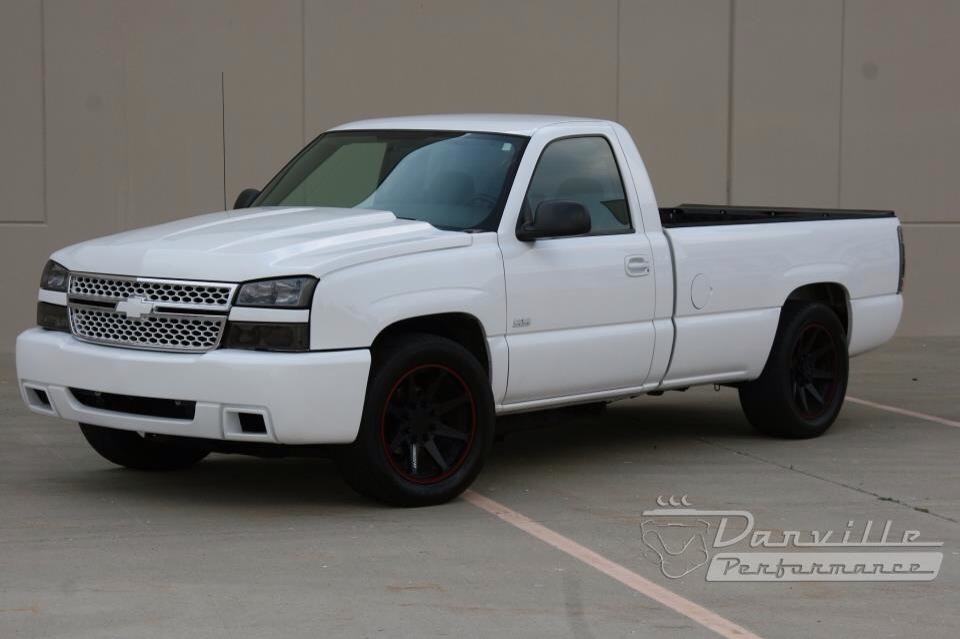

one of the guys from Danville Performance owns this..
Old Feb 13, 2013 | 08:22 PM
CCrowell2's Avatar
Joined: Sep 2011
Posts: 172
That Dmax is cool but its a long bed still

Yeah that's still a heavy duty.

Ill have to dig the pics off the ole laptop there was one around here forawhile it was a conversion it was a long bed 4x4 shortened to a rcsb it was clean as hell only give away was the eight lug and badges
