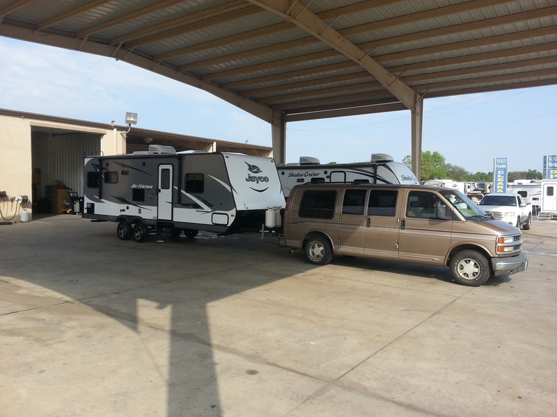

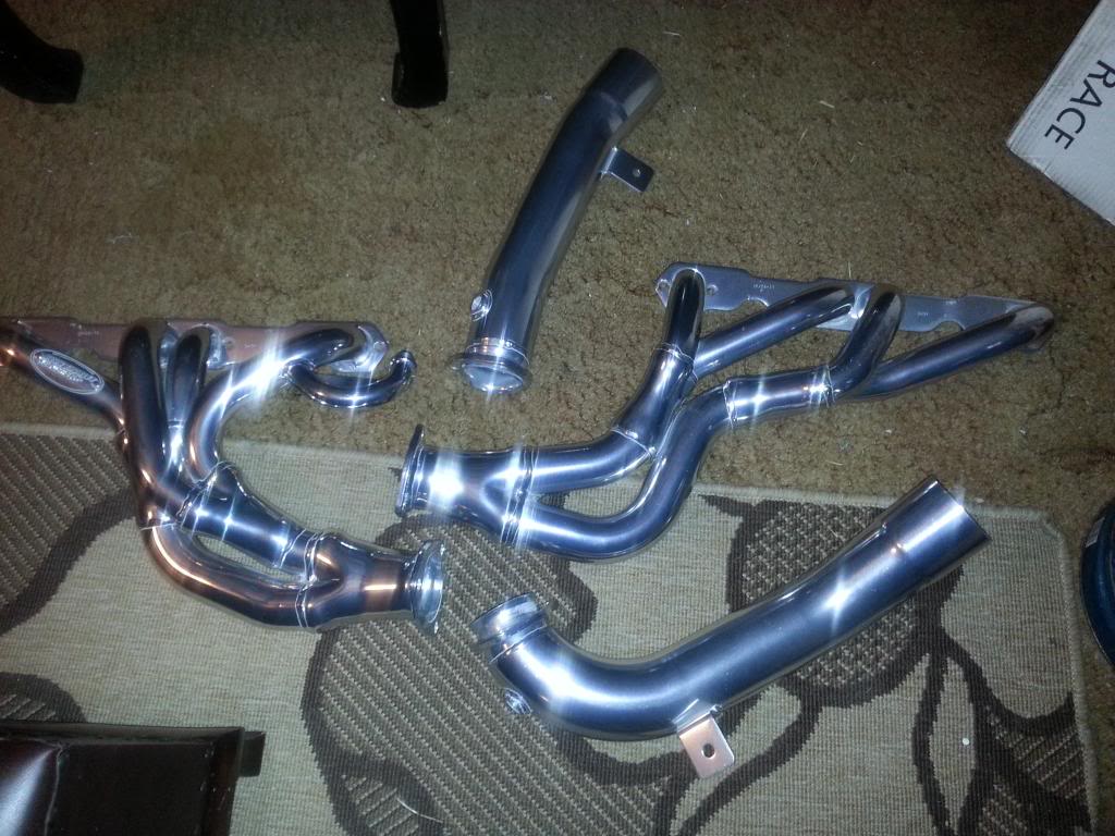

I will say it again for the guys complaining about lack of torque from massive *** header primaries WRONG for their setups!!!!
These on my now 196/206 @ .050 cammed 5.7 with ported 906 heads and a marine intake. Notice if you will those are dual 3" headpipes even. The 1 5/8" primaries and 2.5" collectors work great for grunt.
Allow me to pull this down the road at ~ 2,700 rpm (where I am already making over 400 ft/lbs) @ 65 mph with the converter locked up and maintain speed and even accelerate up slight grades. Long/Steep hills force a downshift to 2nd/Lock and 4,100 rpm right where I am still making over 400 ft/lbs.
Like I said best of luck making torque without the right headers, I already make plenty and have plans for more gear and cubes at a later date.
