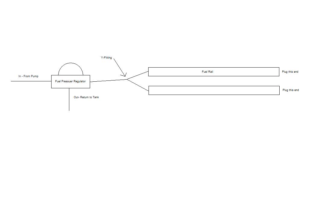

For billet rails your going to have to get an FPR (if you didn't know). For my system that I am planning for my 408, I am bringing the factory line to the regulator, return from reg. to factory return line. Then running the out to a Y fitting and plugging the other end of the rail.

The stock regulator is built into the stock crossover between the rails. So if you remove the stock rails, you have to add in a regulator. Which rails are you looking at?

Generally you want the regulator after the rails so the regulator only has to handle the excess fuel and not all of it. On a NA setup I doubt it will matter though.

That is the reason why I am doing it that way. It is easy, cheaper, and I don't see fluctuations in fuel pressure being to big a deal in a "smaller" cube N/A setup. On boost, not so much.
