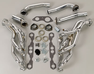

I've heard good things about Doug Thorley headers on these trucks. I dont know if they fit on 4X4s though... Ill look into it and keep you posted.
Here you go:
Doug Thorley midlenght headers for 96-99 5.7 4X4 GM pickups: Part # THY-301Y-FED
Doug Thorley Website LINK (Third ones from top)
Summitracing part # DTE-301Y-FED LINK
Some info: Thorley headers are designed to outflow your stock exhaust manifolds. These headers increase gas mileage and give your engine more horsepower across the entire rpm range. The Tri-Y configuration builds the most power in the middle rpm range, which is great for towing and steep grades. To make these headers last, Thorley made them out of durable 14-gauge mild steel, with 3/8 in. thick flanges and 5/16 in. collector rings. To prevent leaks, these headers have an O-ring welded into the flange, in addition to the high-temperature gasket provided.
There is also THY-301Y-FED-C LINK for ceramic coated.
Hope this helps.
