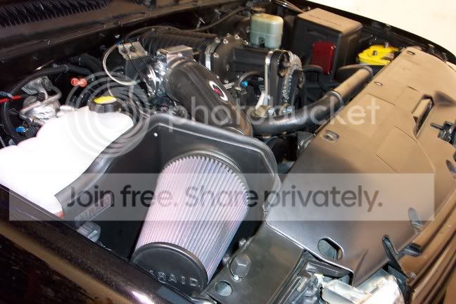

No complaints with my nick williams. The UMI is a great choice too but it wasnt out when i did my setup.You will need to port the j-tube big time and end mill the two lower holes in 4-6mm to work still using the top center hole to line everything up. The UMI uses a 4 bolt ls2 pattern. NW has both 3-4 bolt pattern.
Here a pic of my NW

Nice!!! Thanks blown 364!! just what I was looking for.
