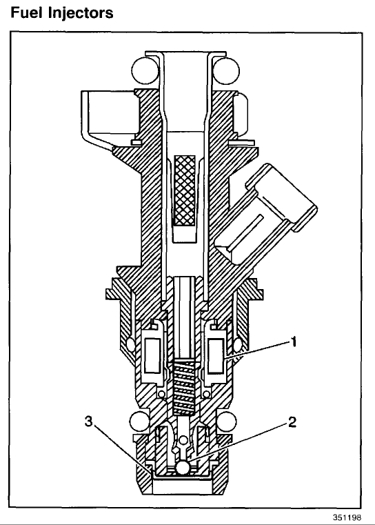

Originally Posted by bigguy75inches
some one told me that the stock 8.1 injectors have 2 holes,, my rc 42#hr have 3 holes, and the mysterious injectors i got now have 4 holes in the bottom, i wonder if they are even higher flowrating than the rc's?
According to Alldata, the oem part number is 17124531. Also, if this description is accurate, I read it to say there are 4 holes.
This is from Alldata:
"The Multec 2 fuel injector assembly is a solenoid operated device, controlled by the PCM, that meters pressurized fuel to a single engine cylinder. The PCM energizes the high-impedance (12.2 ohms ) injector solenoid (1) to open a normally closed ball valve (2). This allows fuel to flow into the top of the injector, past the ball valve, and through a director plate (3) at the injector outlet. The director plate has four machined holes that control the fuel flow, generating a spray of finely atomized fuel at the injector tip. Fuel from the injector tip is directed at the intake valve, causing it to become further atomized and vaporized before entering the combustion chamber. An injector stuck partly open can cause a loss of pressure after engine shutdown. Consequently, long cranking times would be noticed on some engines."
So I would figure ALL Delphi Multec 2 injectors are of the same description. Get them flow tested if you can.
