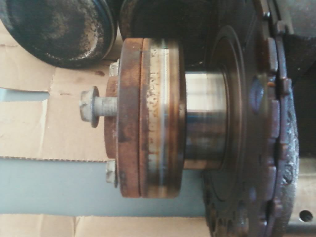

Did you take the 4L80 crank spacer off the back of the crank before installing into a 4L60E truck.

Like said above crank spacer needs removed from the crank to use a 60e. You can see the spacer in this picture. These spacers only come on LQ4's since they were matted to a 80e. There is a 1/8 inch needed between flywheel and converter.

On a sadder note if you did forget to remove the spacer chances are very good you destroyed the trans oil pump and torque converter.

Is that from all year LQ4s? I didn't read that except on 99-01 or 02 models
Mines from an 05 and I dont' think it looked like that.
My truck is an 03 and I swapped the 5.3 flywheel over.
The flywheel from the 6.0 had a spacer on it but wasn't slightly curved like the 5.3.. not sure if the 1/8" difference is made up there.
Guess it's time to pull the trans off

Pull the bolts out and take a screwdriver and hammer and tap screw driver in at the parting line. You need shorter bolts also.
All 01 up 6.0's with 4L80 trans use that spacer.

Are you positive that's the case? I've never heard of that spacer in all the 6L swaps using a newer LQ4. I knew older 99-01 LQ4 had longer snouts, but an 05 LQ4 will not mate directly to the 4L60e?
