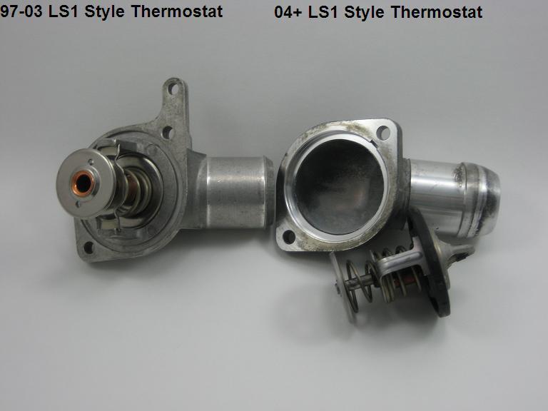

I'm a Motorad 180* guy...
The most important thing to remember is they changed the water pumps in 2004 and the thermostat from the older trucks are not the same...
