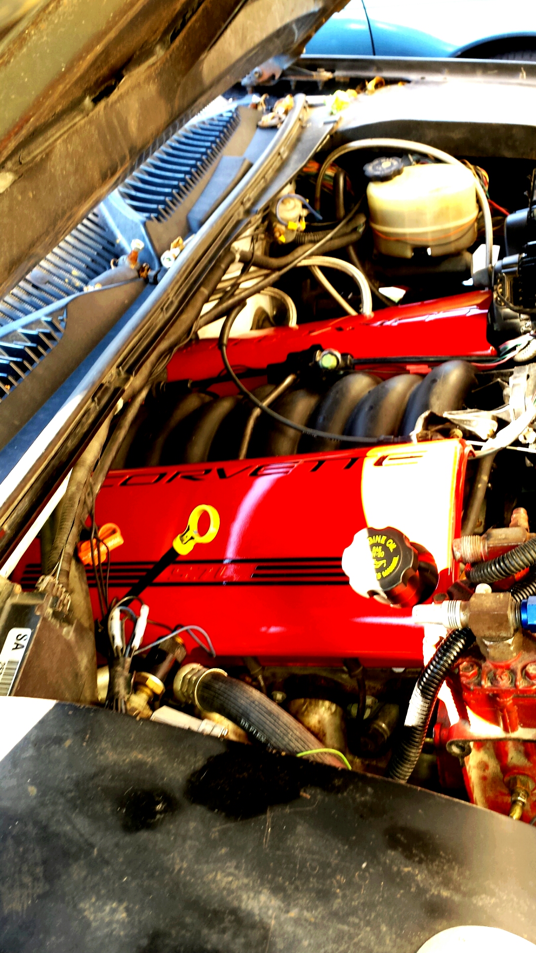

This is a 2001 silverado with TSP 220/220 .581/.581 112 with ls6 manifold intake, pacesetter long tube headers, x pipe stock cats,one dual inlet/dual outlet super 44 flowmaster,,, TSP tune, stock heades 862 I think,, not sure what stall to get maybe a 3200 or 3600 the trany is a 4l60e stock with 3.42
what number I should have on the crank hp
Attached Thumbnails 5.3 tsp 220 cam crank hp ??-2014-09-14-16.40.53.jpg   5.3 tsp 220 cam crank hp ??-2014-09-14-15.46.13.jpg
