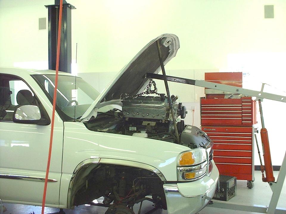

I'm about to do this swap. How are you guys actually pulling the engine out? The unofficial repair book I have says to hook the chains to the header-to-head bolts, but it just doesn't sound safe to me. Or am I being overly cautious?
that's how we used to yank them at the dealer
BUT DONT USE THE ACTUAL HEADER BOLTS!!!!! they will snap
use grade 8 bolts of the same size and thread in those holes
There are also bolt holes in the short "side" of the heads that I used to R and R mine. I was afraid of nicking the mating surfaces on the exhaust header area of the head, especially with them being aluminum.
Used a load leveler type, no issues at all.

I believe the only right way is to pull the intake off,i then used the rear bracket with a chain hook and I drilled a hole in the bracket to run a safety bolt thru the chain.On the front i built a bracket that attached to two of the acc.head bolt holes
